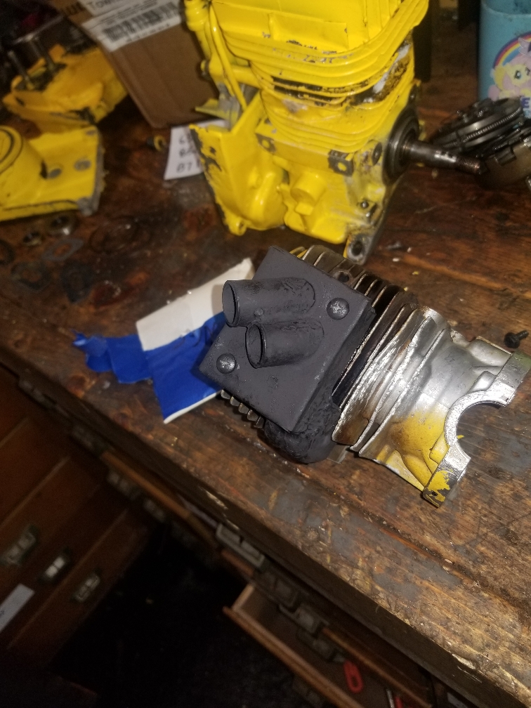

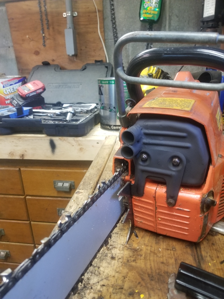

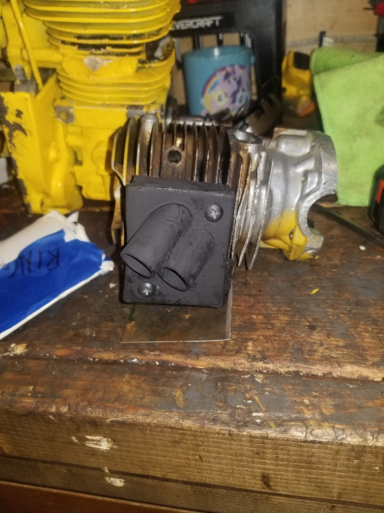

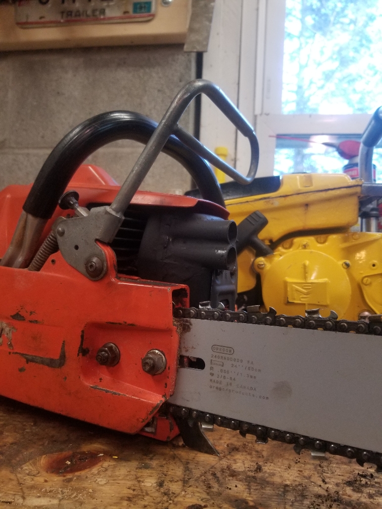

A 2511 that @dall tigged a SS pipe on for me.
Got creative with this Poulan Pro Super 380. McCulloch deflector and I made custom stand offs inside on the lathe, that replaced the baffle.
Most mufflers I see with brazed or welded tubes just look silly to me. But that extension on that 2511 is well done and is actually practical.
The poulan looks nice as well. I'm a fan of louvres for exhaust on a chainsaw. I try to add mine as closely in line with the cylinder exhaust port as possible.

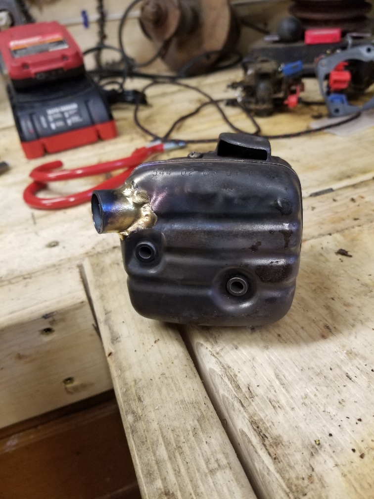

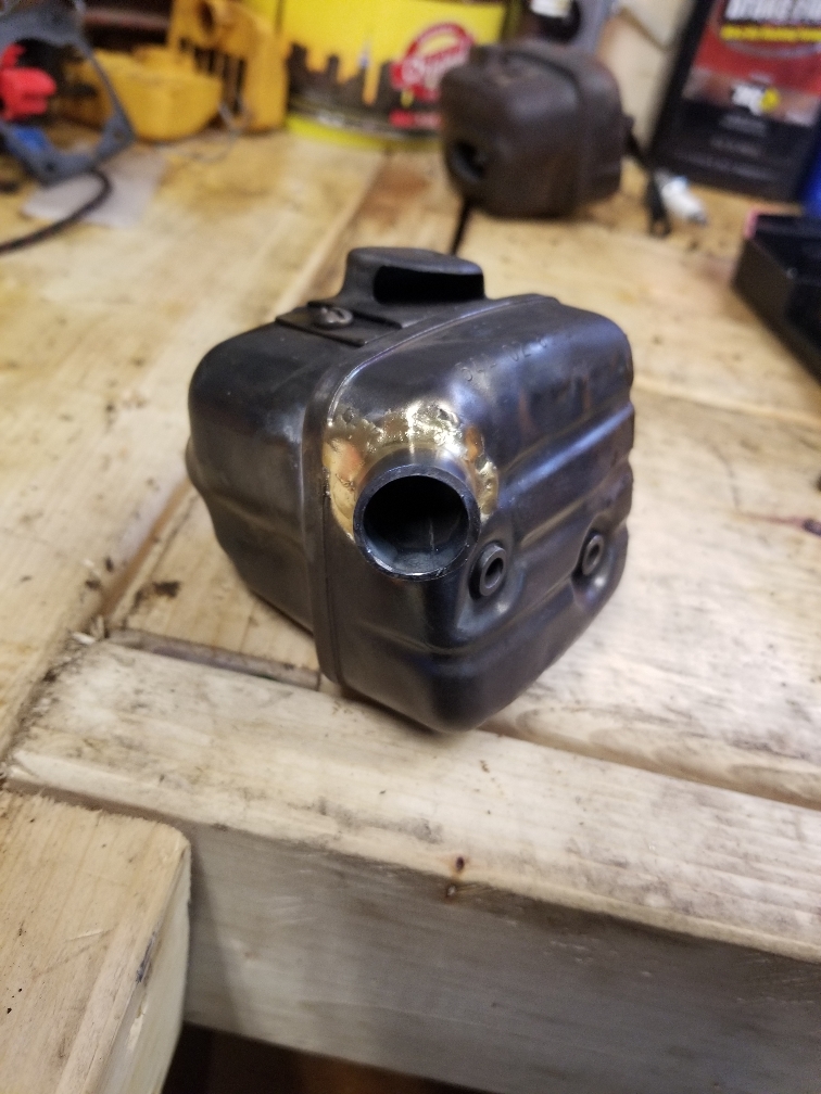

simsponsawshop
10:11 AM
10914
Nov 8, 2019
62
201
Townsend
My latest on a Mac lol. Original was rotted out so I made one. My brazing needs work.
