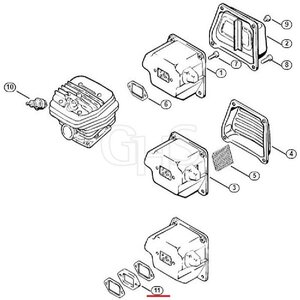

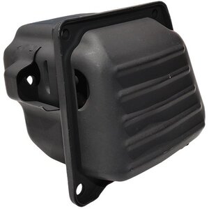

Gents, does the aftermarket muffler for the 064 need the spacer? (item # 11)

Anyone know the difference between the two mufflers in the above pic?.....Items #1 and #3.

I f these are like the 056 saws the difference is in the ?Baffles? that you can't see from the view the pics were taken.

Most visible difference is the flange of the muffler where the two bolts 8 go into the case. The newer muffler has an arched flange edge, the older one on the bottom a flat flange edge. I believe the older mufflers weren't as deep as the new ones, requiring flange 11 to seal againtst the cylinder. Newer mufflers including the aftermarket ones will fit against the cylinder on all saws. For the early 064 the muffler might stick out a little on the front, requiring the thickness of the flange 11 behind the bolts 8

I don’t know which witch is which but iirc the exhaust port flange or case mounts were further out on early saws. So some mufflers are shorter then what an 064 might’ve had. Sort of like a 460 jug on a 440.
