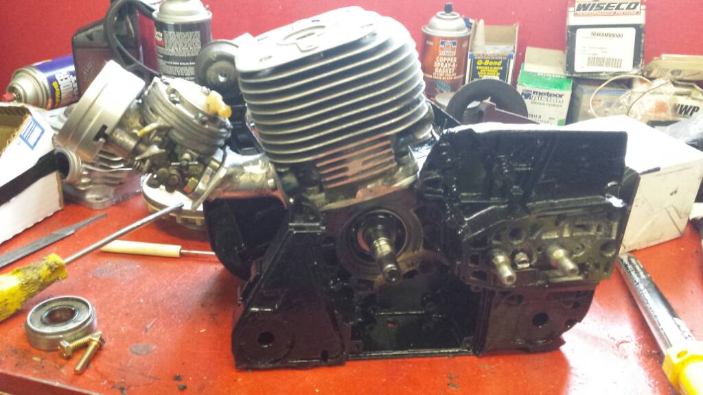

this my o90/088 build I did last year....as soon as I started to make good power the cyl broke in several pieces and trashed everything. ..but the cyl was ported to the extreme and apparently wasn't enough metal left around the transfers...but it was a lot of fun for the couple times I got to run it
Sent from my SCH-I545 using Tapatalk

That is off my first year 046.
It's been ported for almost 10 years and the compression finally got it.
Flywheel side bearing was out and that's why i took it apart,had no idea the cylinder was broke.
It was still running and not really to bad
It was slow back to a idle.
My brother in law had it for the last couple years.
I can have it back now that it's broke. Lol
