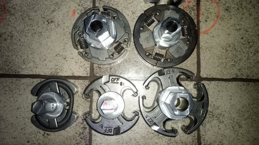

I made my own clutch removal tools.
5:03 AM
15,122
60,545

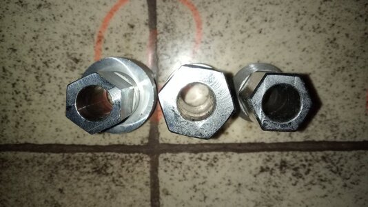

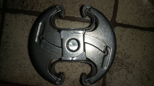

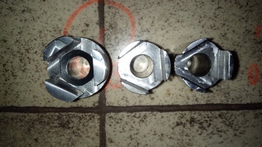

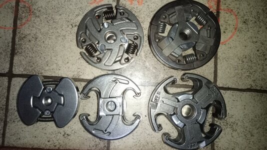

My custom made clutch removal tools, three Husky, two Dolmar/Makita.
My Husky 365/372 tool does not fit a Dolmar 79xx clutch, I made it too beefy.
It could be made to fit, blasphemy though given the effort invested to make it.
The flimsy tool in the link You posted will most certainly fit a large frame Dolmar clutch.
I just kinda went haywire beefing up for longevity & durability.
I also chased tight fitment throughout the development from first prototype tools to final production versions.
You can technically just cut up, I think!!! , a 19mm socket.
That was never an option for me though, the metal worker in me did not allow it.
This mid size Husky tool really kicked my butt.
It was a "request" to make it outlive the supposedly chitty OEM one.
It is elaborately contoured in order to have meat where space allowed for it.
It is very snuggly fitting.

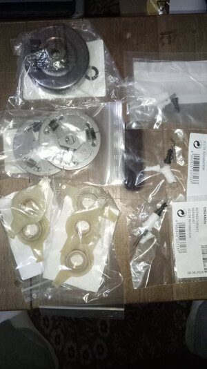

Some of my new spare parts stash goodies.
I need to sort and inventory list everything I have.
I know I have certain parts but can't seem to locate them in the numerous cardboard boxes they are scattered within.
