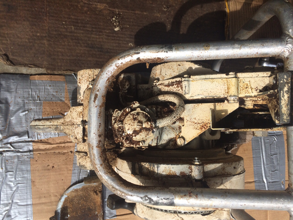

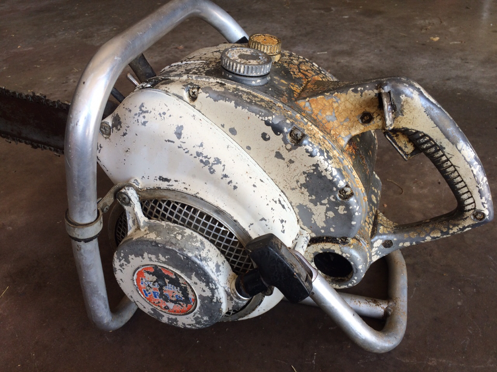

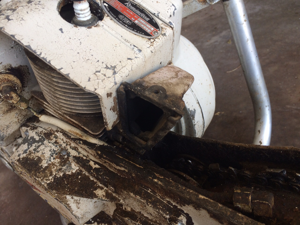

Cleaned off some of the filth.
Needs a spark screen.
I bet it will be loud.

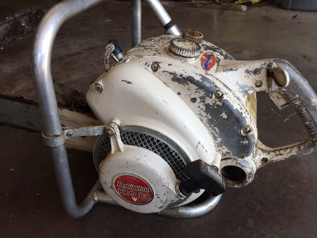

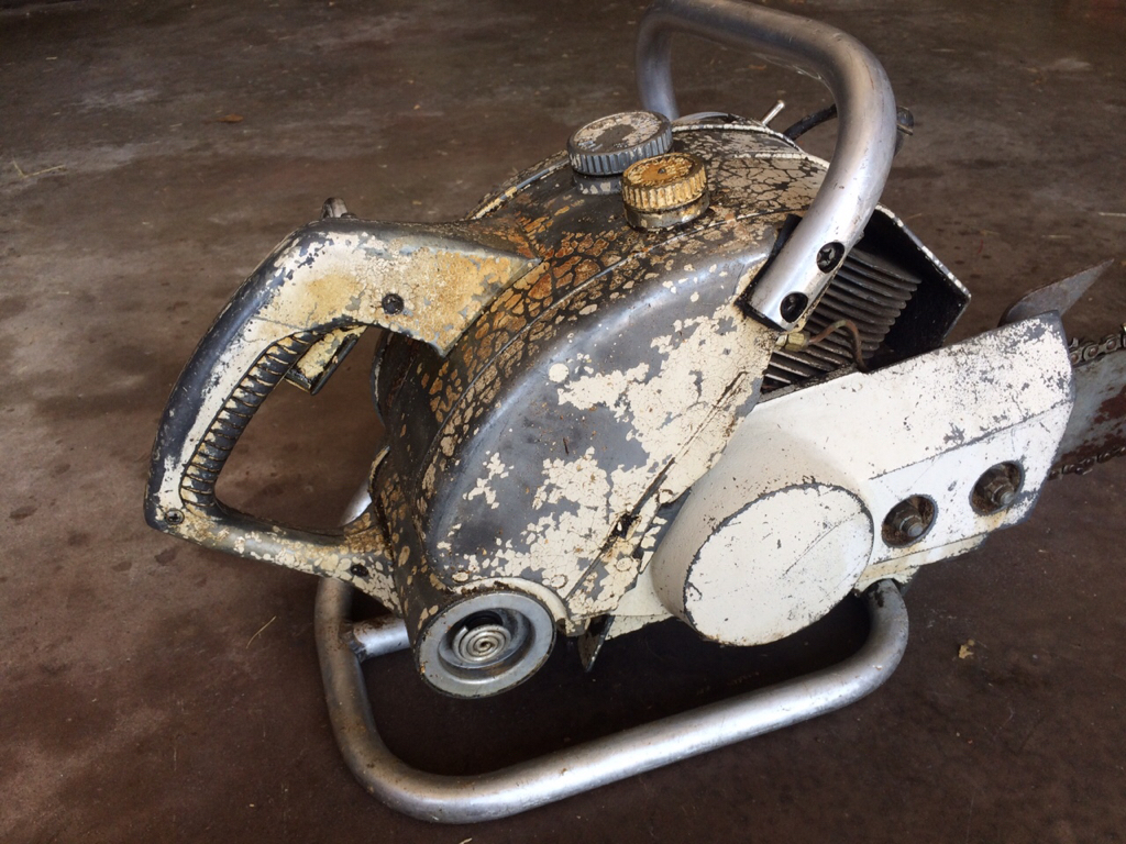

The direct drive:
The paint DuPont supplied to Remington was chit.
Both have clean fuel tanks.[emoji108]No spark, natch. and good compression.

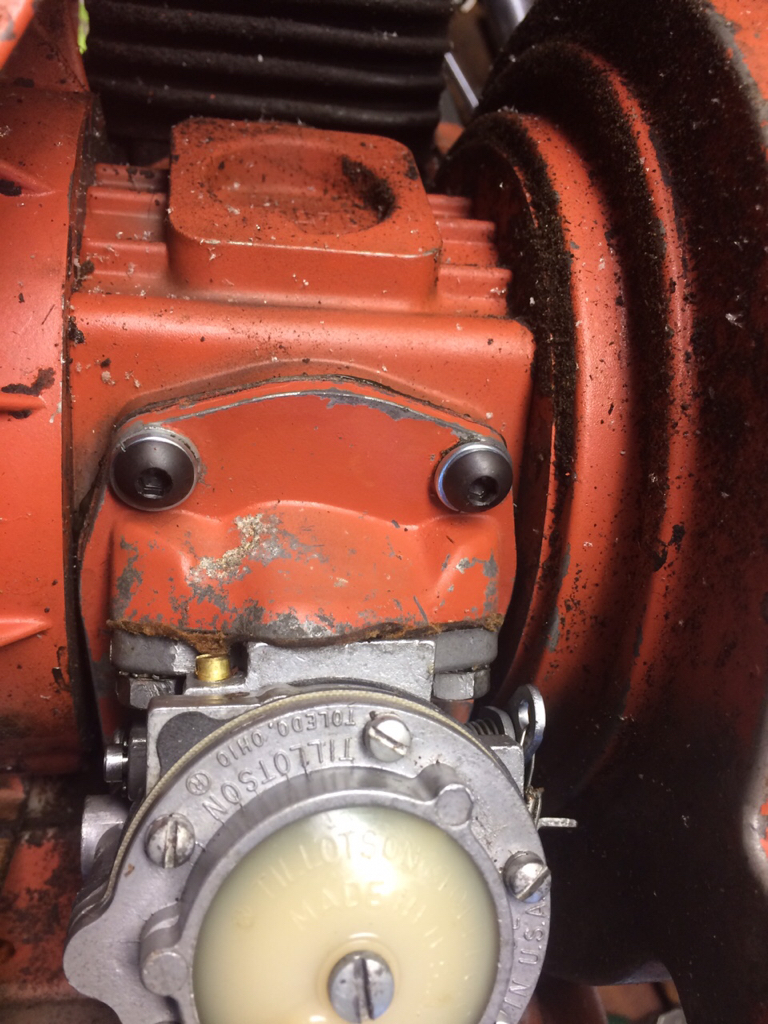

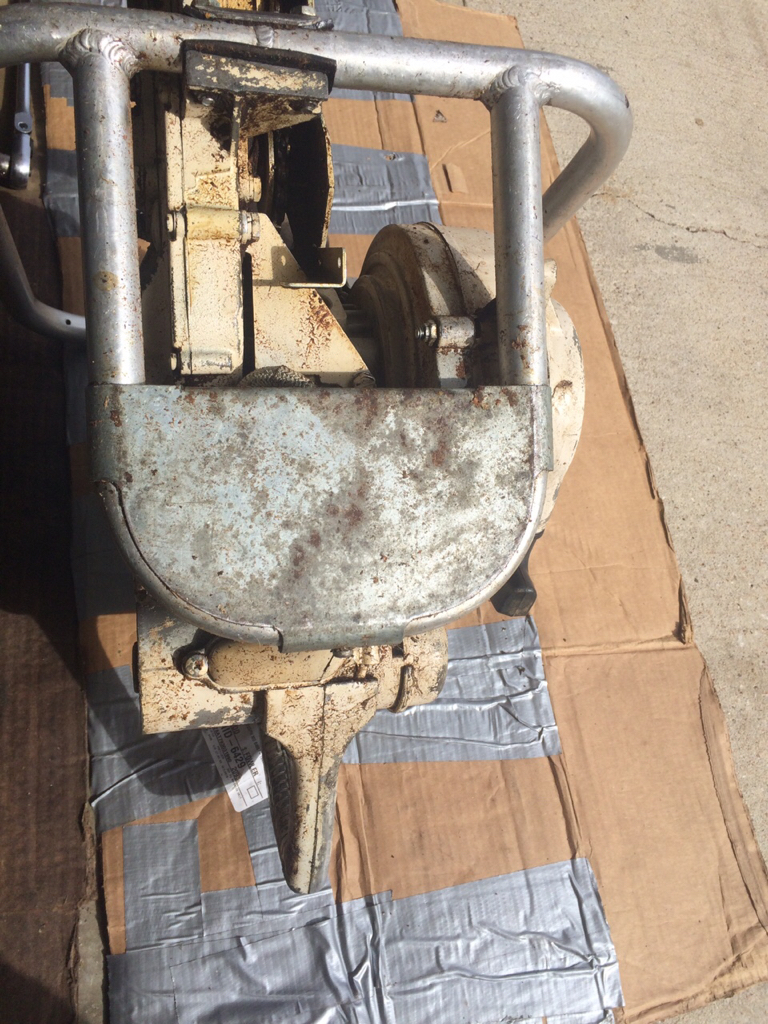

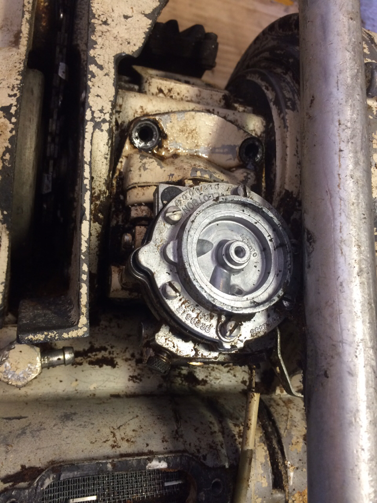

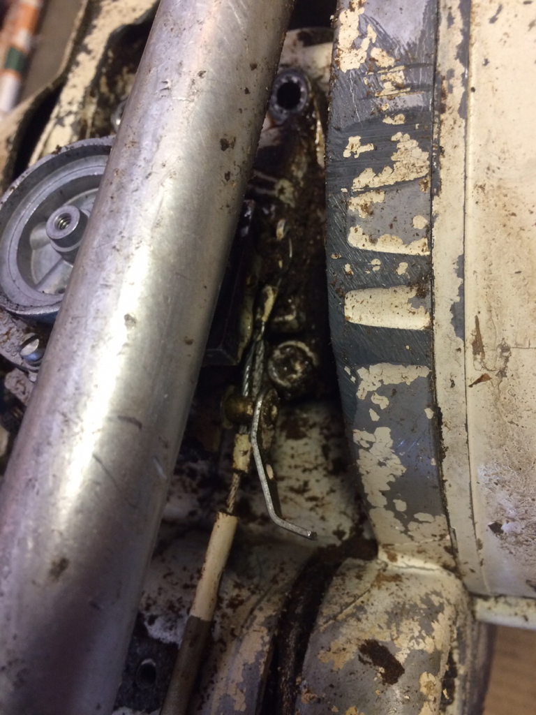

Bottom of the Pro88 gear drive.
One screw and a soft hammer removes the skid plate.
Going to take some fancy wrench to remove the carb.[emoji37]
The next IPL for one of these I see will be the first.

Carl that saw has seen hardly any use. The handle, skid plate,
And still paint where handle mounts, No wear at all. I still
have yet to dig into one of these saws. Would it be easier to
remove the carb with reed plate. I know it's that way on some
Power Products saws and big Homelites to access the carb
mounting nuts.
67L36Driver
8:53 PM
596
9,676
41,674

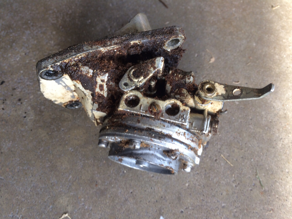

The two reed plate screws above the carb are a PITA. There is no straight shot with a screwdriver.
Carb mounting studs/nuts have no clearance for an open end wrench.

I go back with hex shocket button head screws if I can get the originals out.

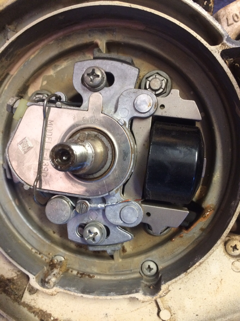

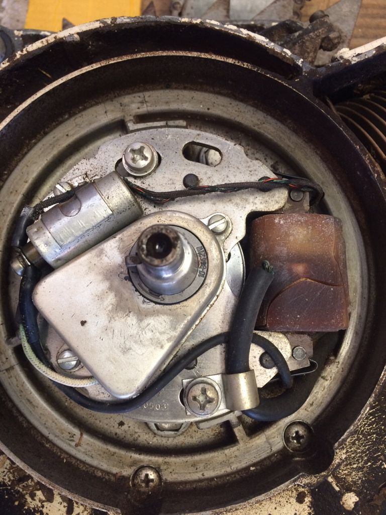

Pro88G has a Wico magneto.
Cleaned the contact points and now we have spark.[emoji108]
67L36Driver
8:53 PM
596
9,676
41,674
Direct drive Pro88 has the Bendix Scintilla magneto.
Typical coil gone south.

The reed 'plate' w/carb has two very hard to get on Phillips drive screws.
Above the wrap and past the choke handle.
I feel like I just walked on water.[emoji15]
