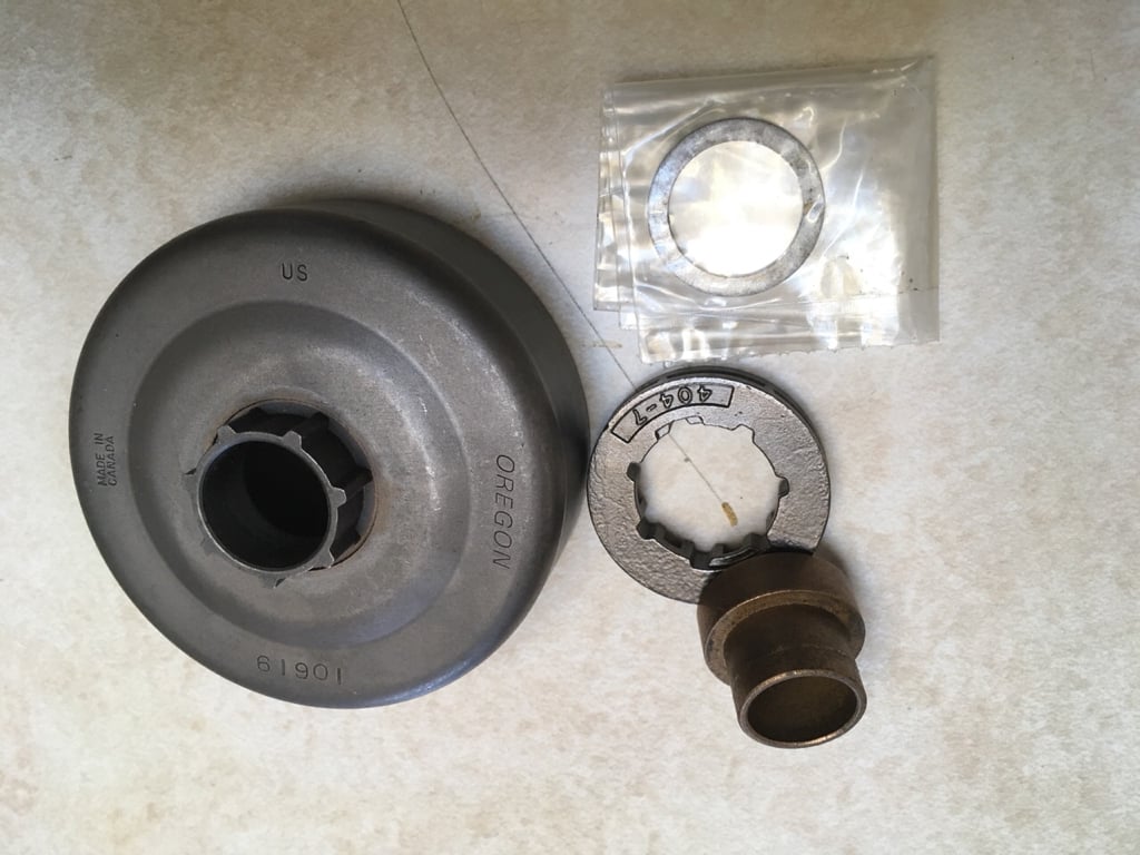

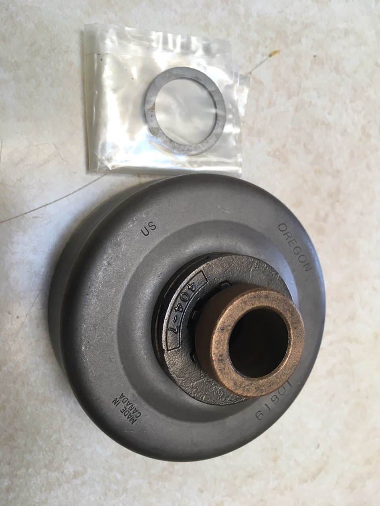

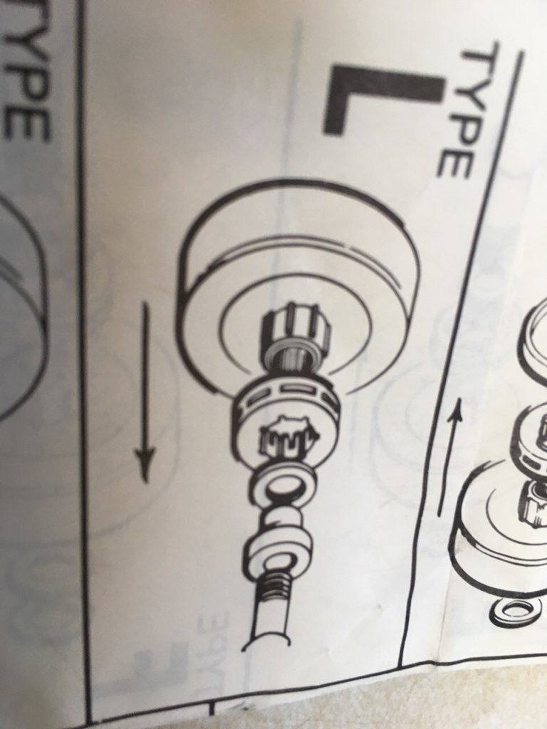

Rim drive setup for Bantam types:
Oregon #10619.
They turn up on evilbay once in a while.
Make certain the bronze bushing is present. Worthless without it.
