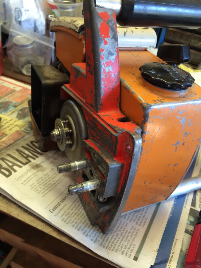

need ipl, or pics of pump side of carter carb. s770. not pullin fuel. also, any hints on getting it out w/o takin the whole mf apart...
TIA

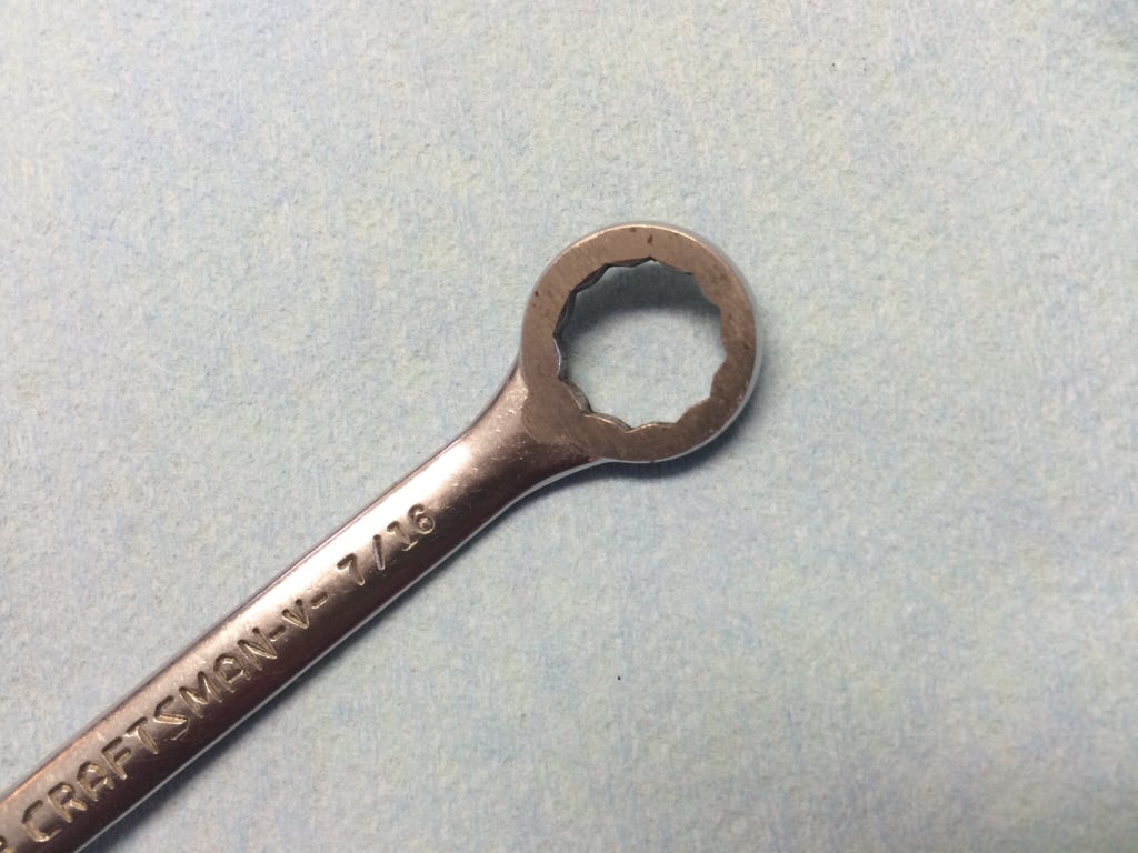

The Carter ND, unlike the Tilly HL, has to come off to get to its works.
Take a 7/16" box end ignition wtench and grind to fit.
The Carter parts illustration is in with the Super 75A IPL.
Look for it on Chainsawr.com.

thanks, carl. its apart & soakin. pretty simple carb. not seein a "check", unless the needle/seat [spring loaded] does that... not knowin how it pulls thru dry line, otherwise... we'll see tomorrow.

Also before you put it back in, shorten the the studs up to just the thickness of the flange plus nut.
