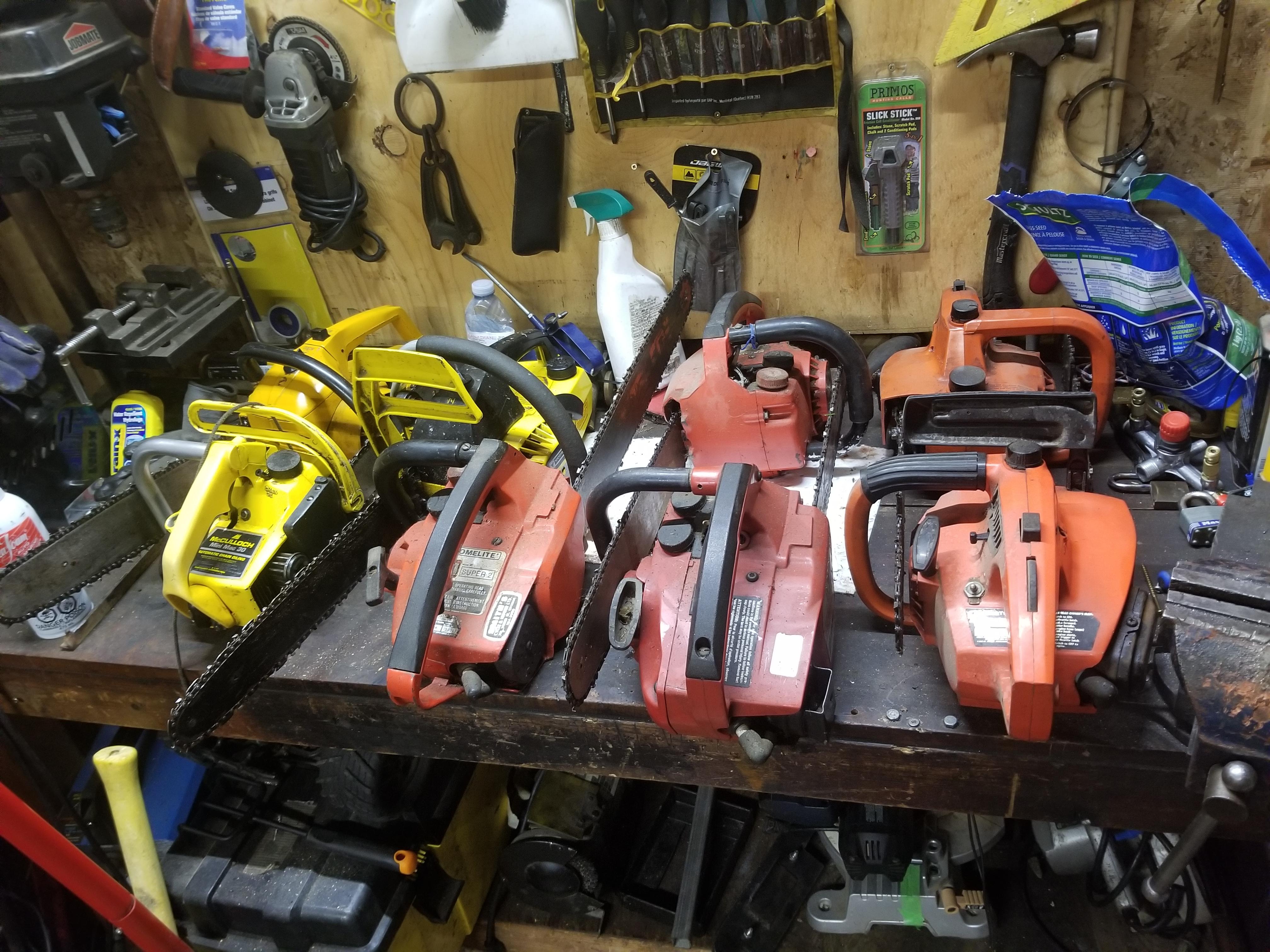

Too many little saws lol. They just keep following me home. And that not all of them.
