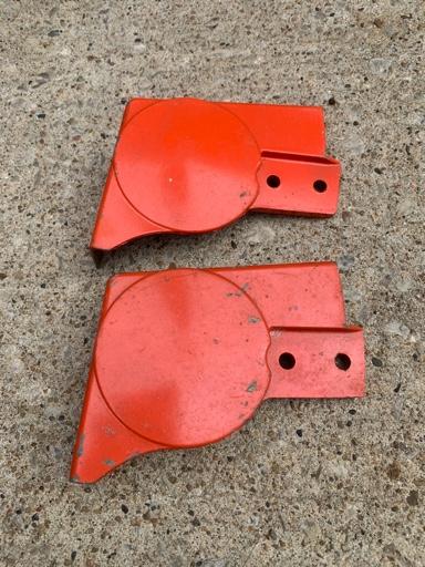

I have two NOS SL-9 type clutch covers I’ve no use for. They arn’t cherry.
PM for details.
