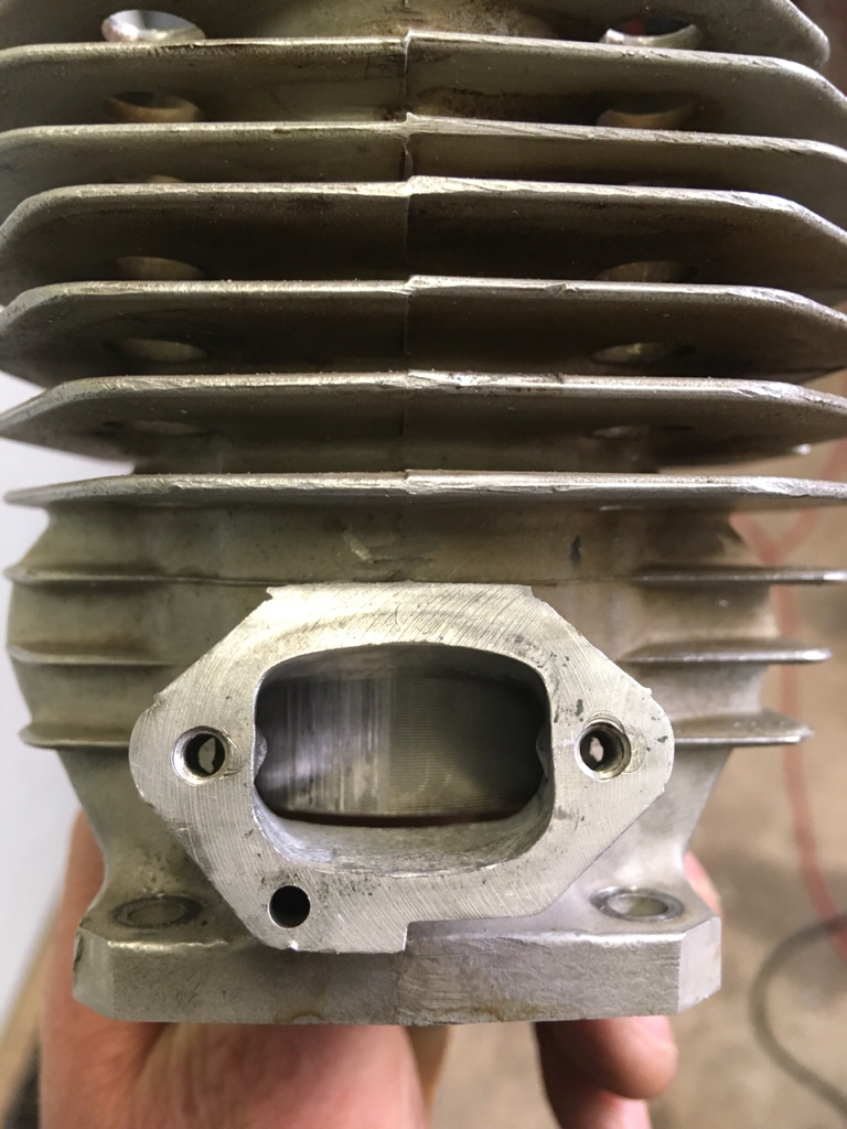

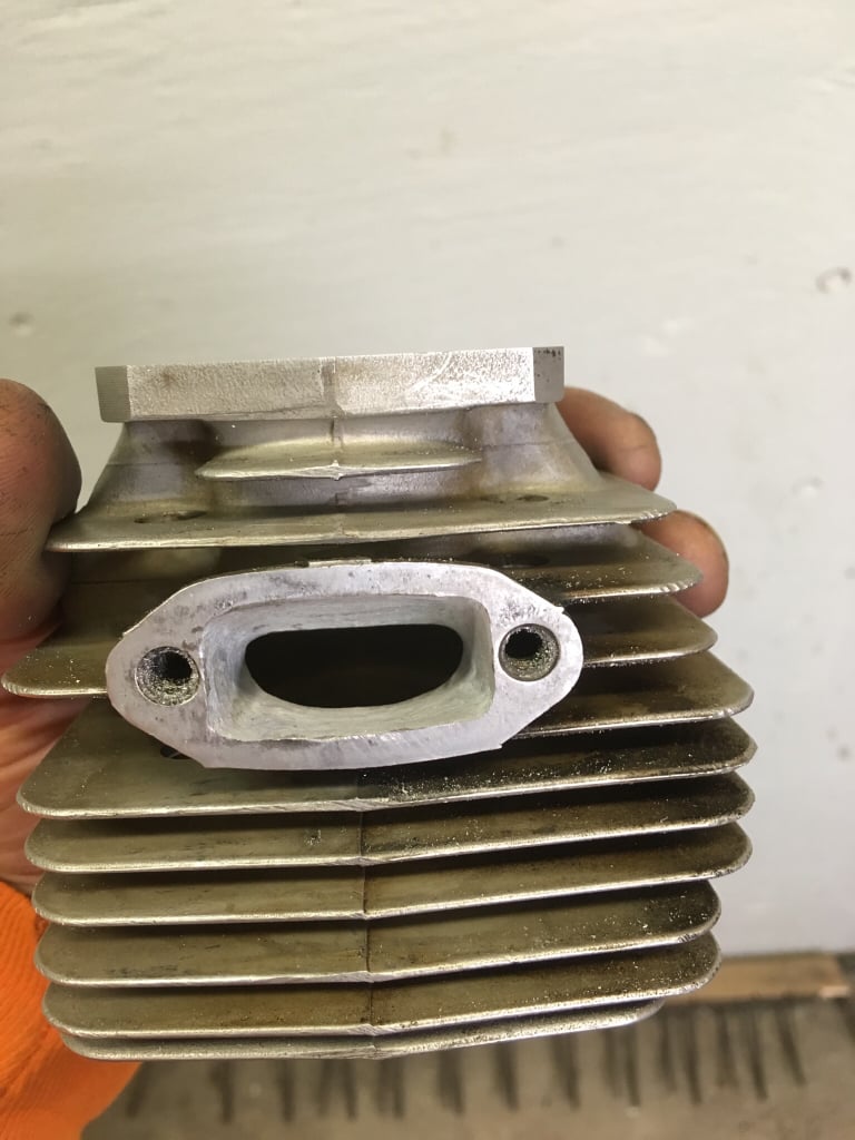

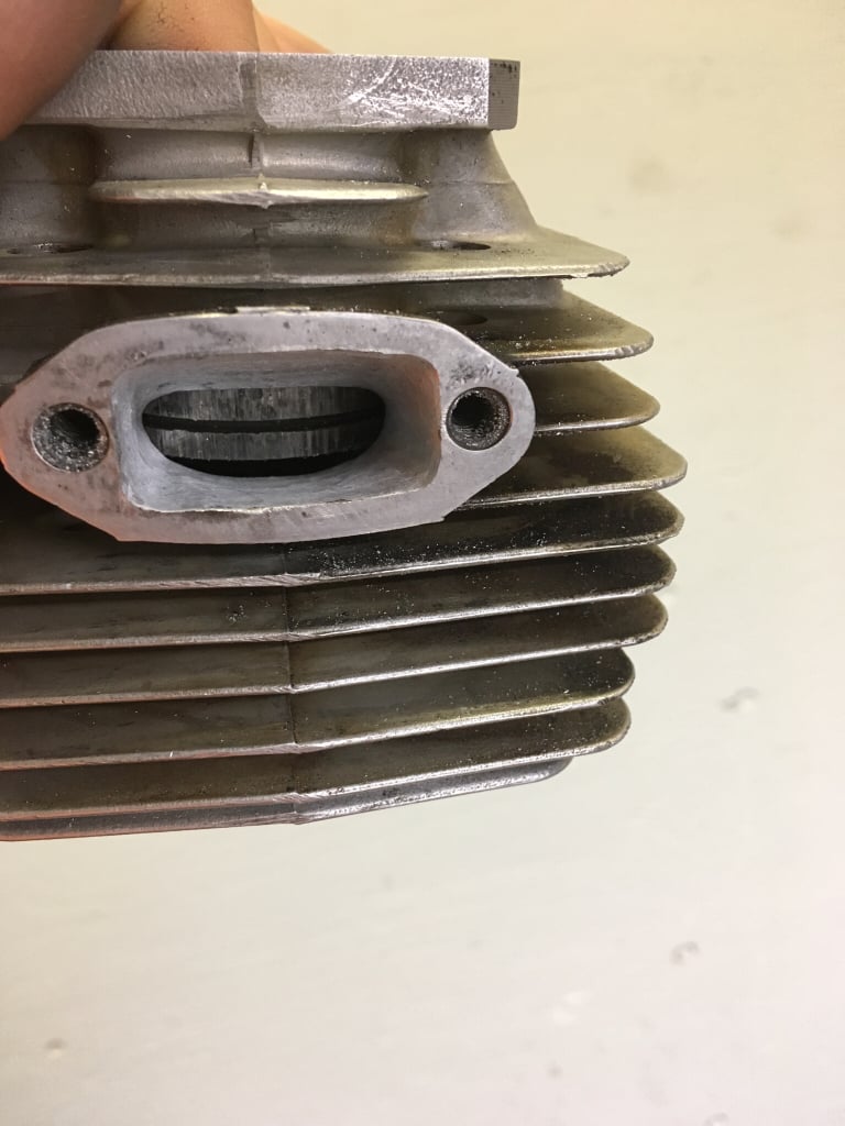

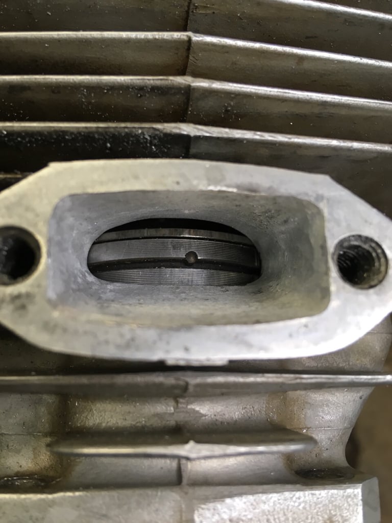

These port were already messed with so I’m working with what I have.
