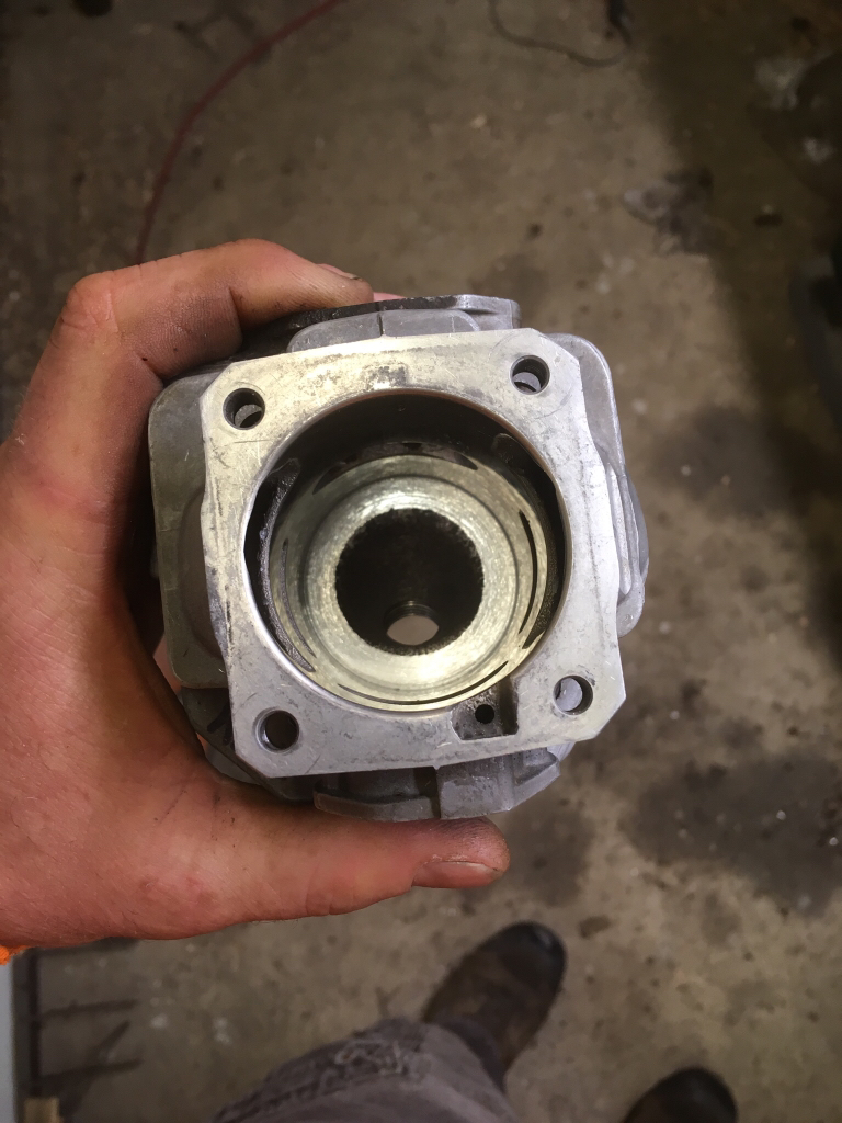

Cutting now
Interesting... took off .005

No! It was factory. Possibly dropped? But it was dead even side to side... you would think just one corner. I didn’t see any tell tale signs of anything but I’ll look closer when it gets off the lathe.
This is a non decomp Mahle
Actually someone has been in this cylinder, and messed with exhaust, intake and lowers. But I see no evidence of the base being touched, and it was within spec of all the others in my base to squish measurements.

This is before I cut Joe. I don’t see any evidence of prior messing with it.
I see what looks like sanding marks on the base, possibly someone used a sanding disk in a die grinder to clean the old gasket off of the base at one time and got carried away?
Purely speculation, nice work my friend.
Well that would make sense. I can see how that would happen.
