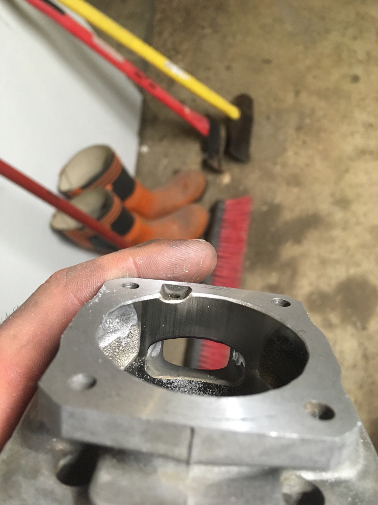

Intake manifold done. I do it just like a port. I take it to the edges, then blend it back to the other side of the manifold.
It slightly asymmetrical, I’m just matching the stock port entry.
