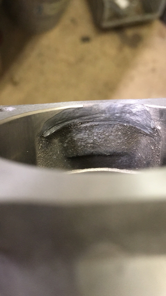

This one was messed with quite a bit and is rough... but we will get her cleaned up.

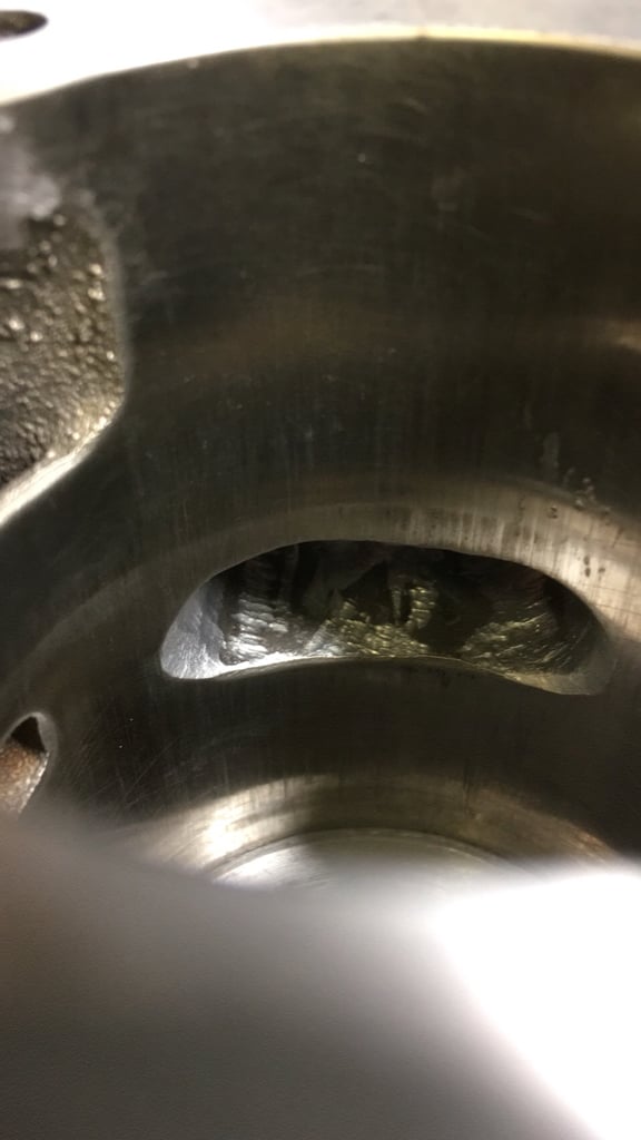

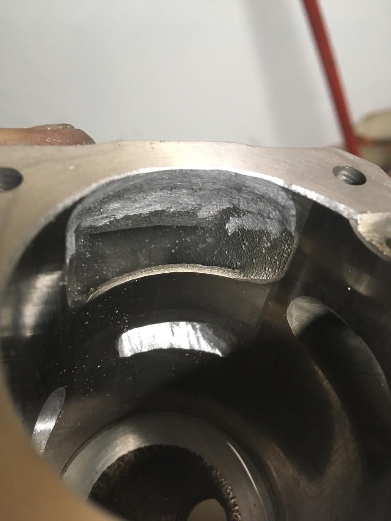

Dan,
How much Freeport are we talking about here?
Can’t make a silk purse out of a bad cylinder. That exhaust port is downright fugly.
It’s extremely close to the edge of the Mahle piston. The meteor is .08 wider, so I’ve got at least .040 to the edge using that.
Thoughts?
I’m seeing how this cleans up. If I don’t like it, I have a decomp cyl I’ll do up for Kyle.

Dan, it’s early.
Thought you meant on the bottom, then I realized. Tough to Freeport the Ex floor on a 262.
I’ve never built a 262 without a meteor. They run fine with them.
Weigh the meteor vs the Mahle when you get it. The meteors almost always look a lot heavier than they actually are.
I think you figured out the solution.
Sorry Bud.

No worries, I appreciate the second set of eyes on this Doc.
