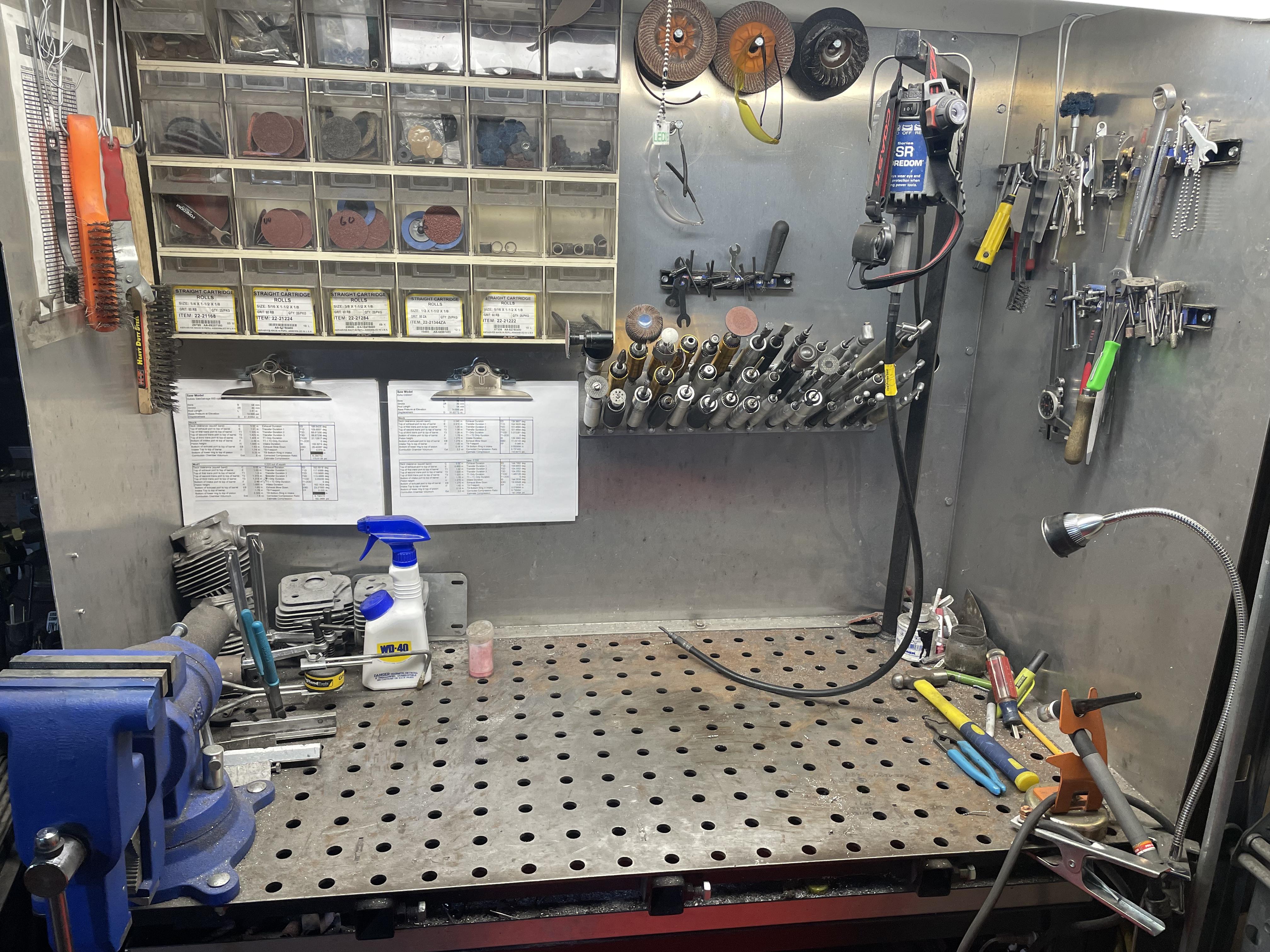

What method are you using to hang your Foredom? Anyone willing to show pictures of your a rope/ pulley system or swing away set-up to allow for better positioning and storage?

You have to hang the motors with something that can resist the torque so hanging by a rope will not end well. Most people make a pivot arm to swing it against the wall when not in use.

Just have to work with what your work area will allow. Mine isn't anything fancy, but it works for me either in the porting vice or in my hand sitting down.
Even hung the little mini welder on there
