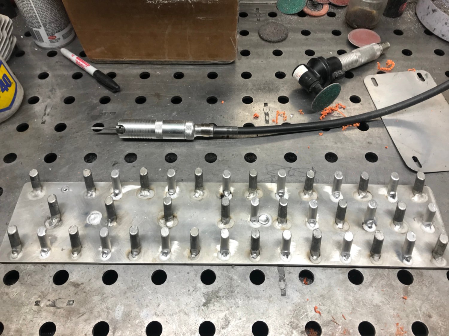

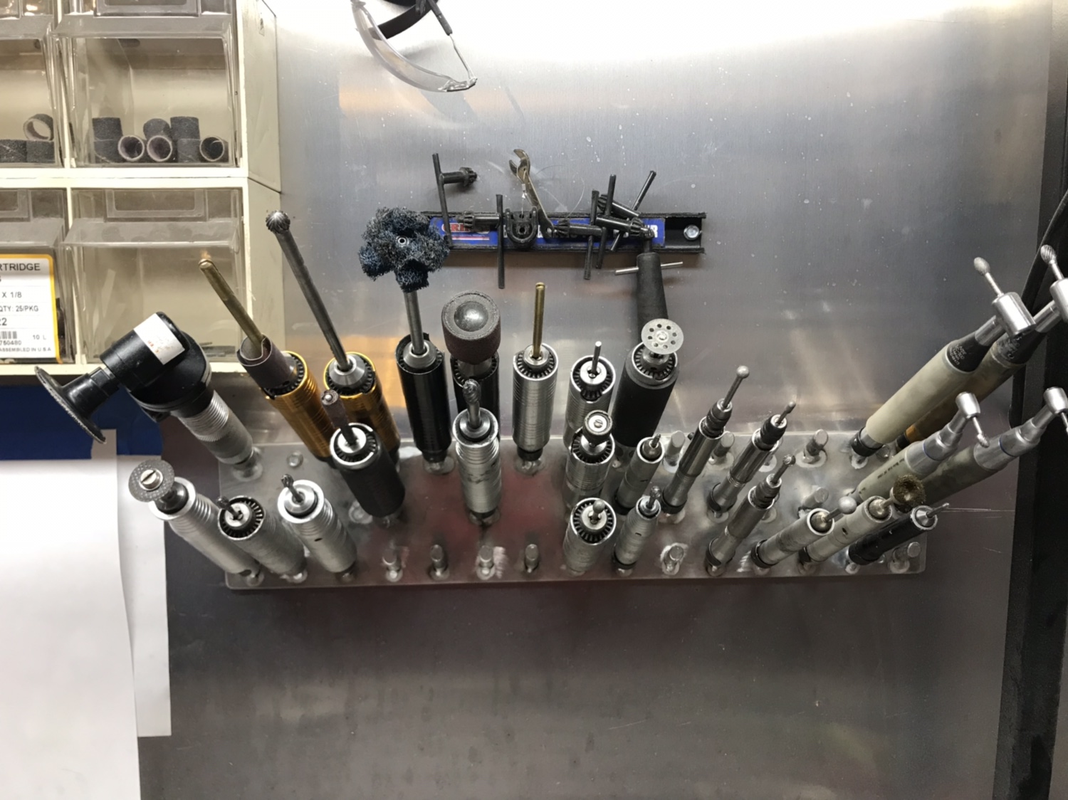

Moar better. I hope this enough pins now.
