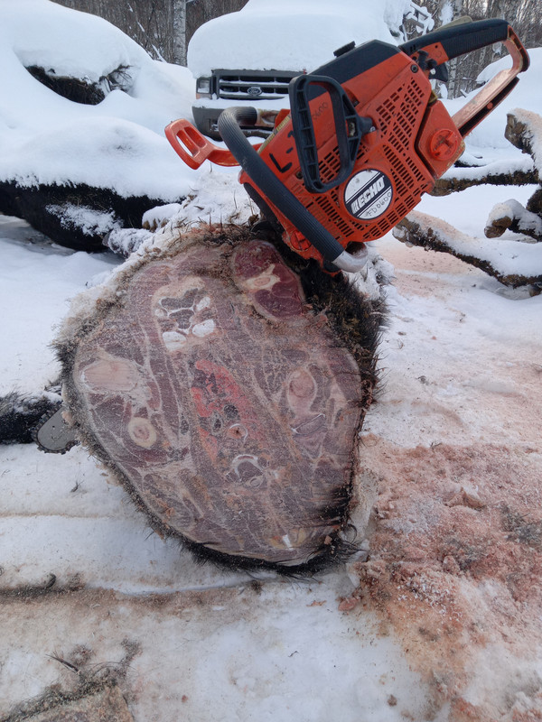

Running 3/8 DPX for thinning alder, at least 200-300 ATV loads drug off into the woods. Had to take the rakers down a bit. Crawling through alder jungle, cutting clumps, the anti-kick back is appreciated.
Stays sharp, will take a few hits to dirt before it needs sharpened. Actually hit a piece of drill rod near a well site. Cut right into the thing. Teeth were all intact.
Been running this same loop of DPX to cut up whole/frozen cows for dog food.
Also running a loop .404 dpx for milling with 42" bar.
Neither the 3/8 or .404 is fast cutting but the durability is great.

Nice saw, but strangest looking wood I've ever seen! :sconf:

I am stealing that photo & putting it in the wood ID thread on FHC.
I like the way you are thinking. 👍🏻
