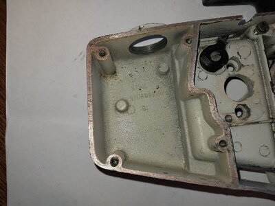

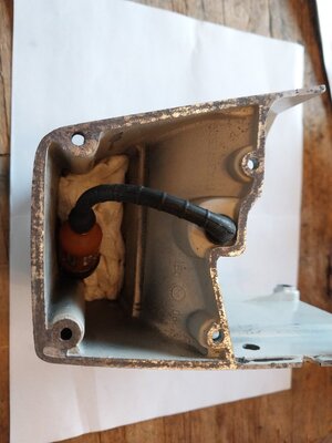

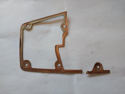

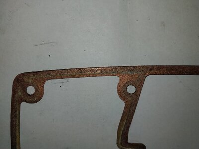

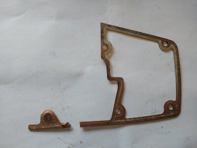

Hi, I have a Stihl 020av that I have been trying to resurrect. It was given to me by a close friend and holds sentimental value. I have probably put more time and money into it than I should have but I have it running like a top. After getting it all put together and fired up It has developed a fuel leak from the bottom of the tank at the gasket area. I have replaced the gasket with new when I had it apart. I used copper spray-a-gasket on the new paper gasket thinking the extra sealer would help make a better seal. Maybe that is what caused the leak. I disassembled the saw today and found that the gasket appeared to sealed well to one half but the flange on the other half, along the bottom, wasn't sticking well. Upon inspection the only thing I see that could be causing the problem is some corrosion pits in the flange area. Has anyone ever had this issue and is there a repair, without replacing the tank half, that would be as close to permanent as possible. I am leaning towards anaerobic sealer or rebuild the surface with JB weld or even using three bond. I will attach pics from both halves. Any input on this would be greatly appreciated.

Try lapping that half on a skeet of thick plate glass using 220g paper. That will show any “channel’ that might cause a leak. The weight of the cover is usually enough pressure…don’t press hard.

Exactly what I was thinking as I was reading ... To get nitpikky I would do the other half as well. VERY Lightl to clean as well to reveal any high or warped places. A cast iron table saw top is a nice machined surface as well.
Like stated above, lapping the tank half will be your best bet, definitely cleaning the edge to make sure there isn't anything causing a bump up that would prevent the two halves from going together flat with the gasket. If you do have some corrosion pitting that needs to be filled in, I have had good luck with JB Weld for filling holes and grooves. I've worked on a 075 and 031 both with leaking fuel tanks and had to split them, clean both sides really well and then reseat them with a new gasket. I used Permatex Aviation Form-A-Gasket (similar to the copper stuff you used) on both sides of the gasket and have not had a leak yet.

Thank you for your response. I will try the lapping of the half. I may have a piece of machined flat stock handy to use. As for the copper spray a gasket. It states that it is ideal for exhaust manifolds, cylinder heads, and turbocharger flanges. It does not say anything about fuel resistance. Out of the three products I am thinking of using only the three bond states fuel resistance. I have used it on air cooled motorcycle engines before and am very impressed with how it sets up. Firm but not rigid. I have used the high temp JB Weld on case halves of aluminum engines with pits with great success. But not on a fuel tank.
Thank you for the information on the JB Weld and the aviation form a gasket. I haven't used that stuff but will look into it. I have used the JB Weld high temp on a 24hp Kohler case half with great results. If the pits are too deep, I dont want to take too much surface material off for fear of alignment issues. I will most likely use it in combination with the aviation form a gasket or the three bond which I have on hand.
