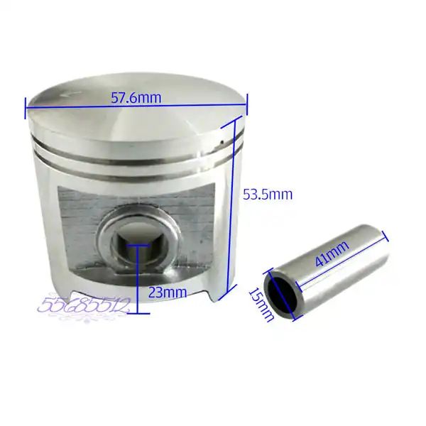

I found this pic of a 070 piston from aliexpress & ebay
58MM-Piston-Assy-Piston-Rings-Pin-Fits-For-STIHL-070-090-Chainsaw-OEM-1106-030-2000.jpg_q50.jpg
Sumbuddy told me they had a 13mm pin, but if the piston really is 53.3mm tall, that's too tall for my project anyway. I'm glad I didn't buy one. Looks like pin center to skirt is about the same as a 395, but way taller above.

I have a box of pistons to add, I haven't had time, that one is not one of them. Sorry.
