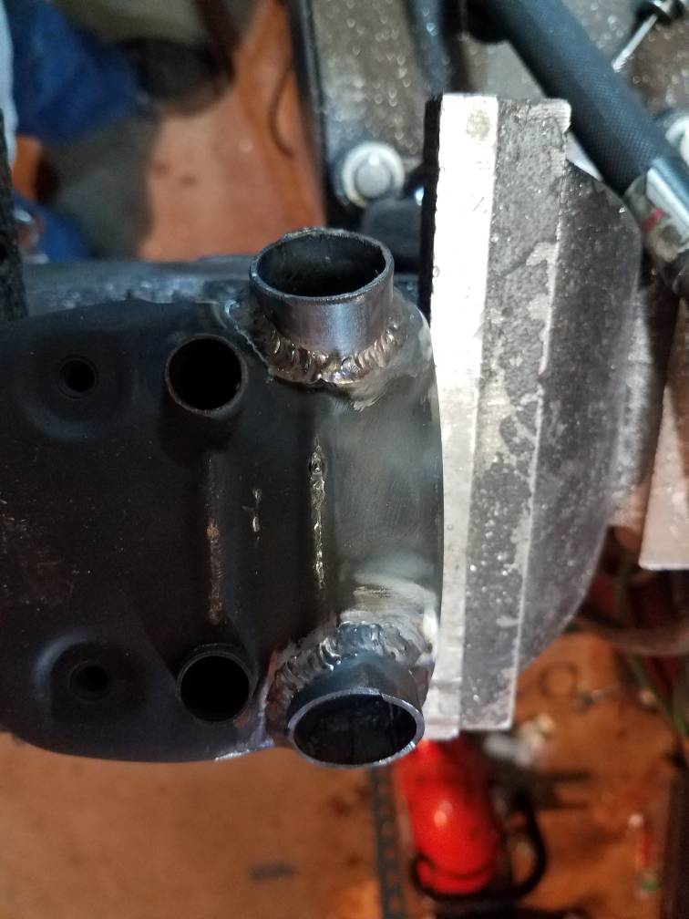

These idle fine.

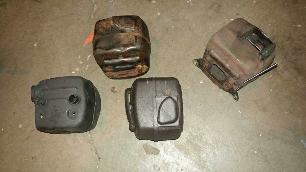

E Copsey had I think a Stihl at the races in Chardon that had a hole 1" wide and nearly the length of the cover .So I thought what the H and tried it on my souped 038 Mag .First I had to richen the idle screw but it did over run the stock Bing carb .Didn't work for me .
Didn't hurt the saw,fact I used it today .The cut up cover is someplace in my garage amongst the other assorted junk .

In a race saw application, one large opening in the front cover seems to be the fastest.
For a work saw in big wood I'll take a dual port, one on each side with a solid front cover. Or a tri-port.
I've never cared for the tone or performance of an outlet on the side and one on the cover in a dual port
