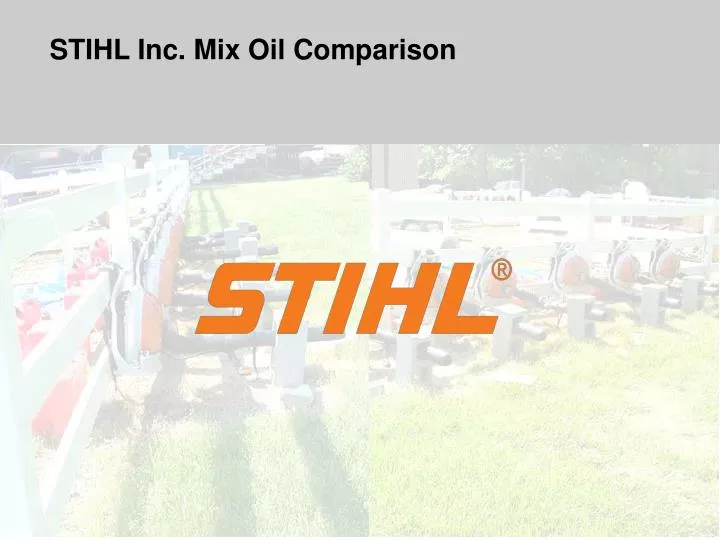

Check out slide 11 - the results will surprise you. I cannot find the msds sheets for motomix - must be a “secret proprietary ingredient” in it ! Any fuel that increases compression over 500 hours is worth investigating

That test looks fishy. I’ve seen buildup in engines like that only once or twice, and that was on high hour trimmers getting run without debris shields. ???
An example of 1 is statistically meaningless.
The most important alide is the one showing the valves. Notice that all the air cooled low ash oils show significant ash buildup on the valves, while the ashless Ultra does not. Ash buildup is what causes valve adjustment issues with the 4mix engine, which is why I recommend running Ultra in a 4mix.
I would absolutely not run Ultra in a two stroke chainsaw.
The methodology of running the engine wide open for 24 hours is laughable and blatantly favors an ashless oil like Ultra BTW. I addition such a test doesn't resemble how these motors are ran in real life at all. Sort of like the guy doing the high ratio trimmer tests on this site years ago. A good test needs realistic operating conditions and a statistically valid number of test units.

I’m 99.9% certain Husqvarna uses a similar 200hr continuous wide-open throttle test on their chainsaws (55 minute on 5 minutes idle) … I’ll see if I can find it in my archives to get rid of the fishy smell 👃

Its very fishy for the reasons I pointed out.
Its funny how much residue all oil choices except for ultra have.....
Especially slide with sparkplugs....
Amsoil @1:100 has the same deposits as mineral HP or Echo blend @1:50
LoL.....

Plus.....if OPE was running wot most of the thime....i would expect at least spotless sparkplugs....no matter which oil was used...
