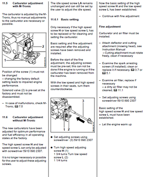

I have a new Stihl FS240 brushcutter (done about 3 hours work) that I'm having problems tuning by ear, I believe the initial carb setting are 1 to 1-1/4 turns out....At 1 to 1-1/2 turns on the H screw its still not 4 stroking and seems to be reving far too much...I'm running a fuel / oil ratio of 32:1.

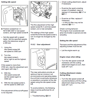

Absolutely right with using 50:1. Modern oil of today is much better as it was in the past. These machines are built for 50:1 and run a very long time with it, if taken a little care. If you don`t have a tachometer and don`t know the proper settings go to your dealer and let the dealer check it and do the tuning. Also you will not know if you hear 4 stroking or if it is the electronic rev limiter, therefore a tachometer is needed.

It will produce a lot carbon and clog the spark arrestor for one thing.
Note has a speed limiter set at 12,500 rpm [10,500 rpm if RC version] so these rev a lot higher.
To properly adjust the carb you need a tach and then follow the following instructions.
