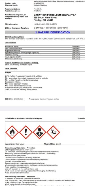

The canned fuel like motomix is 99.99% alkylate fuel - it’s simply the finest fuel you can run and has a shelf life of 2years. Iirc motomix has 10 chemicals in it vs over 100 for pump fuel and those 90 are toxic as heck! It also has more btu per gallon than pump fuel … Dukes in PA has aspen fuel available afaik and you can use your favorite mix oil if STIHL ultra isn’t to your liking
Motox mix may be 99.99% alkylate, but others are not.
Its mixed with Ultra oil, which is garbage so its not the finest.
I am well aware what pump gas has in it and what alkylate is. I make the stuff for a living.
VP, Harvest King, True Fuel and others all sell canned fuel without oil in it that you can mix yourself.
In a two stroke Its somewhat beneficial to have a few other components than straight alkylate.
The other thing is alkylate is a toxic chemical, which you dont seem to be aware of. Attached is an MSDS for alkylate.
