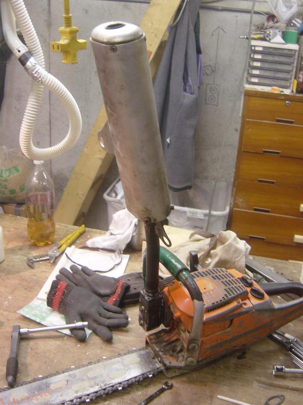

Did not want to cut my 394 plastics but it looks like a must for a large pipe.
I already shared this with you didn't I?
https://www.ablett.jp/workshop_archive/csm2.htm
I'm hoping to avoid the 3120 with an 084.

Ive got an 084, also got an 088, along with the 3120. If you are going to be milling with a chainsaw , sell the 084 and get a 3120. Heck, sell or trade whatever you can to get a 3120. Husky basically made it for milling
Lastly, I suggest doing whatever you can to direct the exhaust up and away from where you are going to be, plastics take a backseat to fresh air here
When my yoke is finish none of that matters much.
Going with a two to three foot extension on my header pipes.
