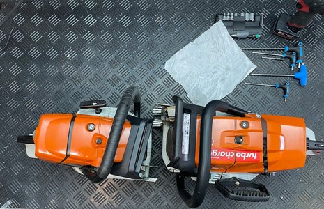

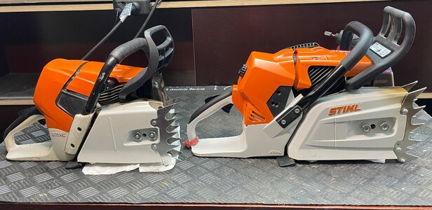

You’re not gonna mill for long with a ported 661 before it blows and it costs the same as a stock 881 after you pay for a good porting job. If you want to mill the stock 881 will always cut faster in wood in the 36”- 84” bar range, and do it reliably as it can handle the heat soak and load substantially better. It is slightly larger, but only in length and weight.
As @mainer_in_ak said, there are other options for milling like the echo1200/1201, but with this part availability isnt an issue, oil pump can be upgraded etc. Overall I’m satisfied with mine and its seen alot of work with no issues.

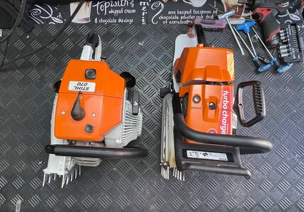

Here’s a pic of it next to 661 from a few years back when I got it. From what I remember the 881 is 4 inches longer. 3rd pic is a new old stock 070 a friend snagged from fb marketplace for $500 😳

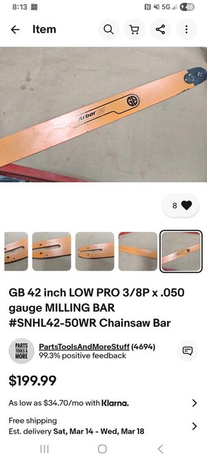

I would gladly plug a 42" 3/8 low profile milling bar on that 395, buy a 25 ft loop of stihl 3/8 lp pmx milling chain and knock out slab after slab after slab. Depending on grain and species, really wide slabs are worth a ton of money.
Just a heads up, a 42 inch bar fits perfectly on the 36" milling frame. Gotta run a 3/8 lp rim though.
