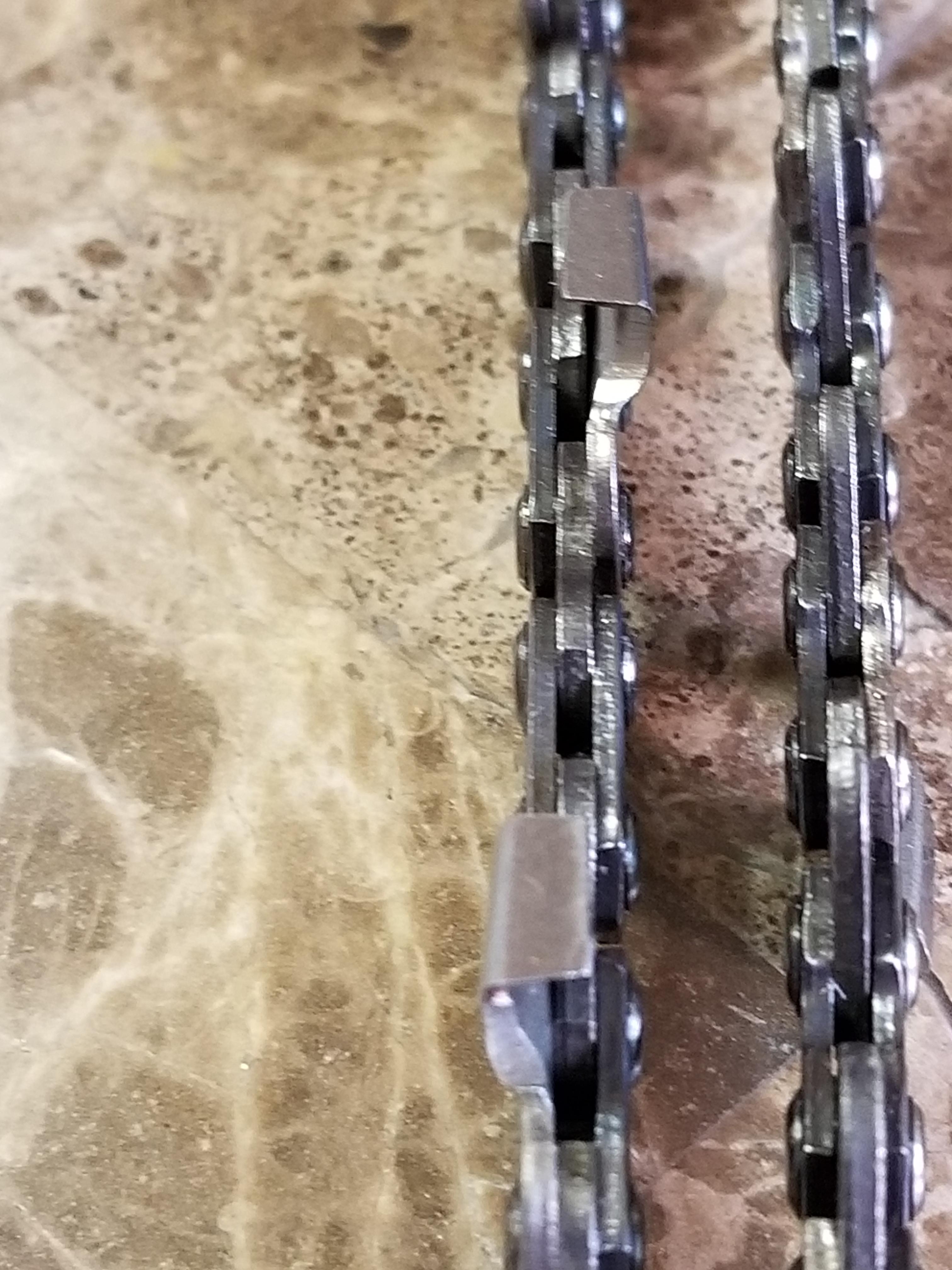

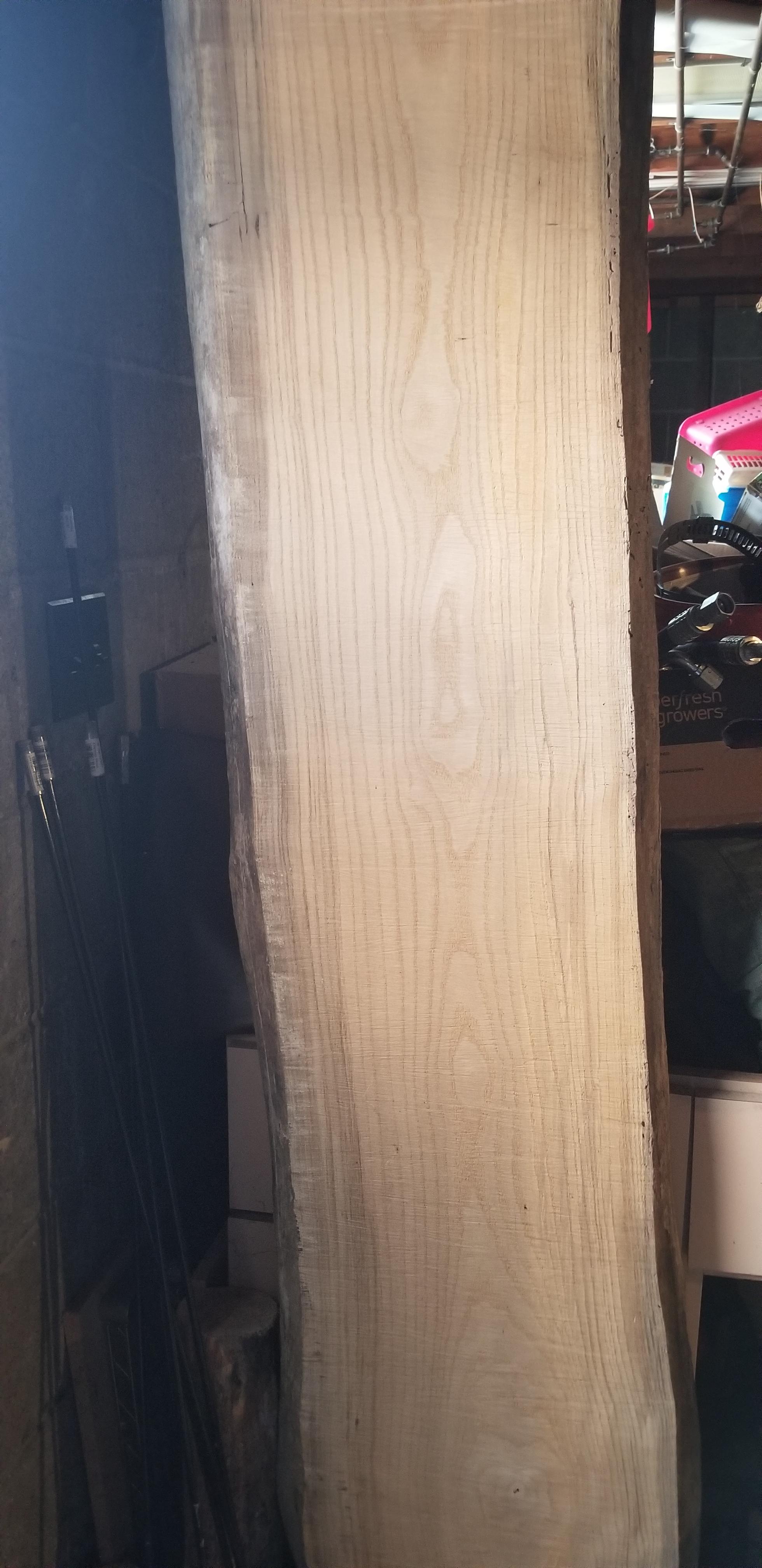

I get that tareout myself on hardwoods and soft. Look at your grain angle there. It seems the rift sawn wood is ok but as you move to the flat sawn in that area, oaks especially cause of the rays, tareout.Milled some more today.

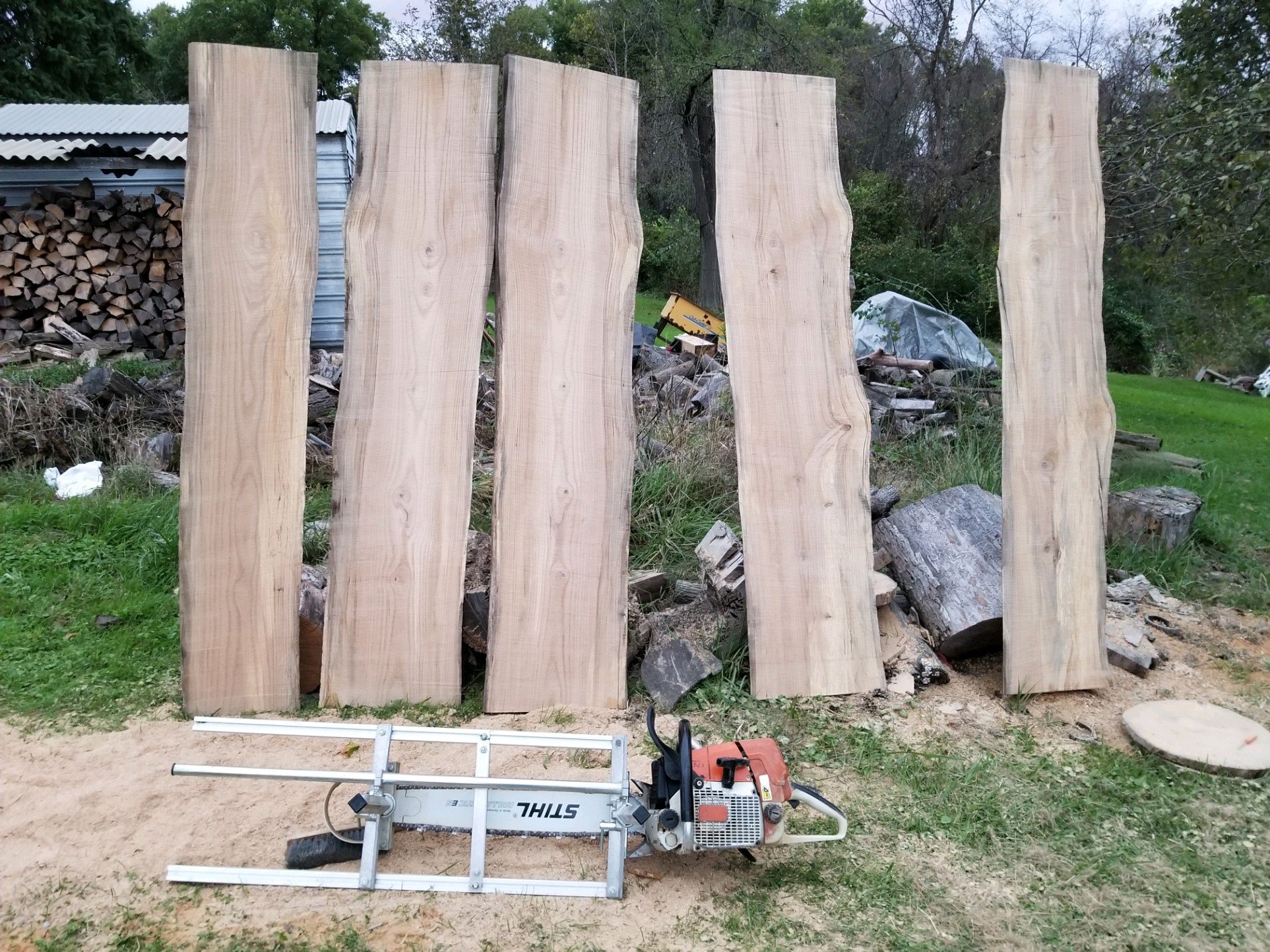

Pretty smooth. Full comp LGX, 93 drivers, 3/8 50 squared.
Bottom side, meh.

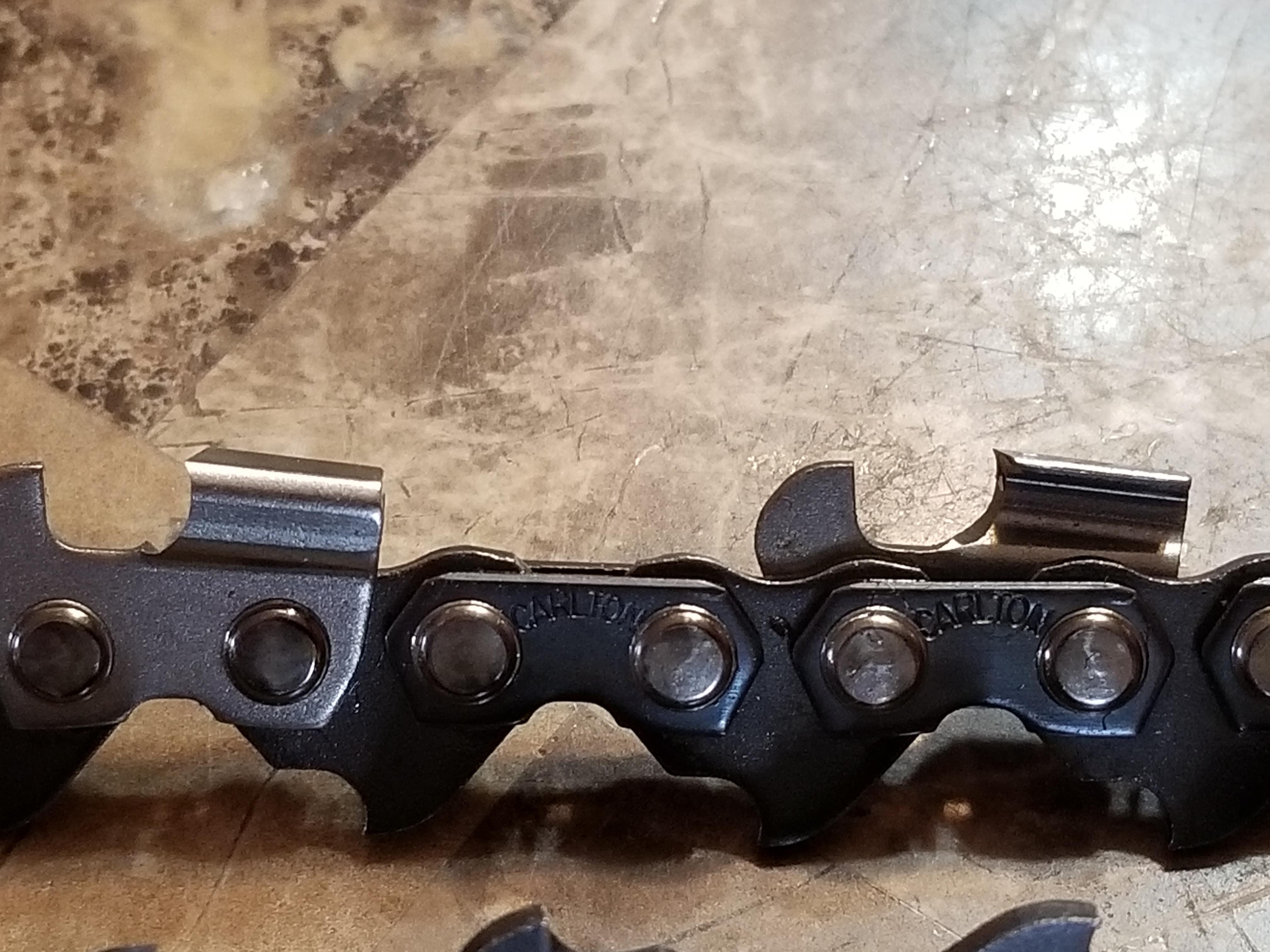

Do you see it with beach or sycamore with the chain top plate angle your using?
