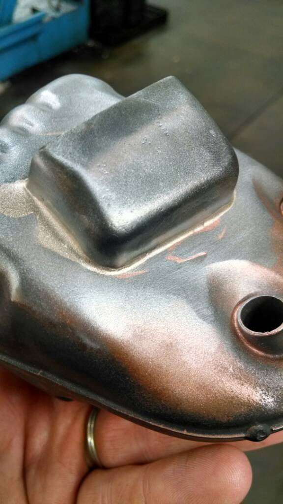

I'm finding these super difficult to get a nice bead on. My welds come out quite poorly on them.
I'm not sure if it is embedded impurities in the base metal or not. I can get them to seal, but they just don't come out like my other beads.
I always sand blast my mufflers clean before welding on them. It does help a lot.

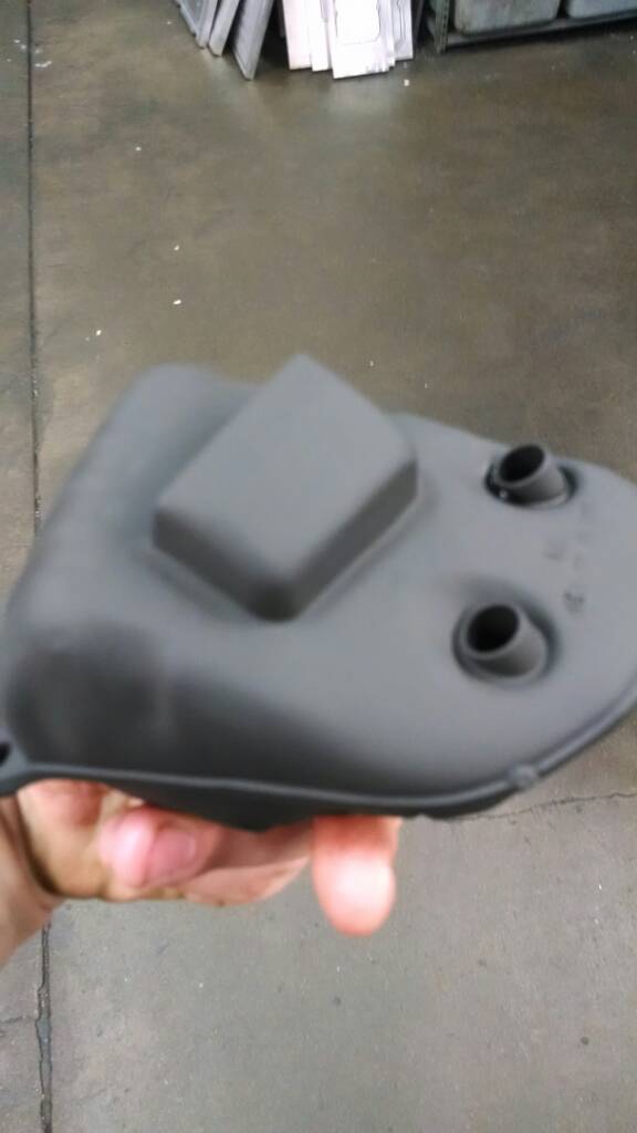

If anyone is wondering on that Craftsman 3.8 you do not see any weld where it attaches to the muffler it is because I took a burr and shaped the muffler for the pipe to slide in to the muffler and then welded it from the inside. Just makes it look cleaner.

Exploding welds will be impurities in the metal for sure
Pulse is a must on thin stuff.
Exploding welds can be moisture too. Best is to bead blast and throw a little pre heating at it. That may settle it down. Normally it's the cheap Chinese steel that explodes the best. [emoji12]
