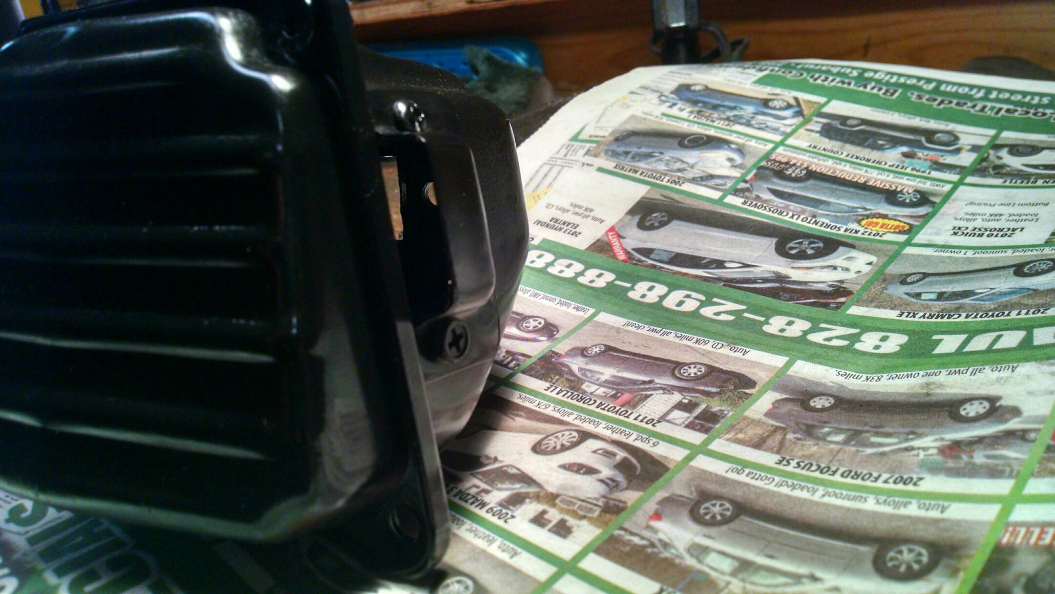

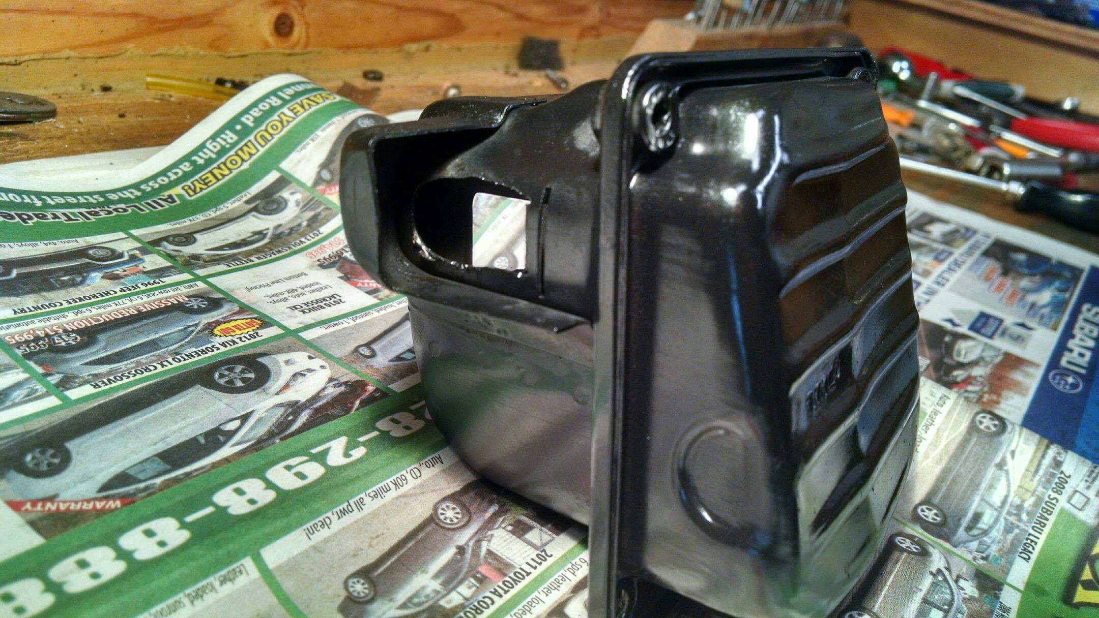

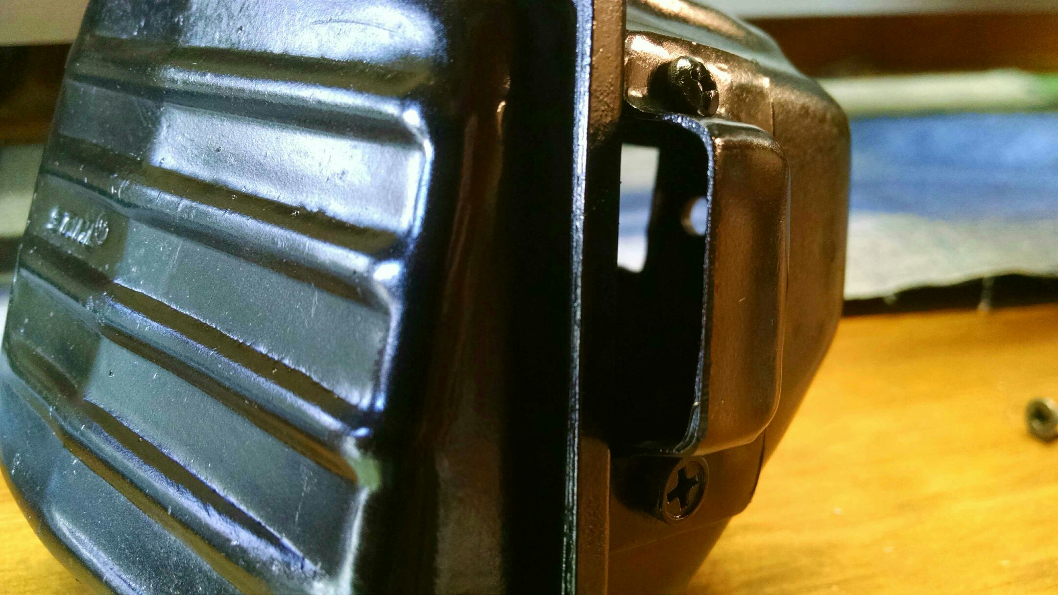

Here are a few pic,s of the 3120 muff this thing is choked to death and I believe this is a very big contributeing factor to why the P/C were in bad shape.IMG_20160509_173753460_HDR.jpg IMG_20160509_173806204_HDR.jpg IMG_20160509_173832146.jpg IMG_20160509_173823029.jpg

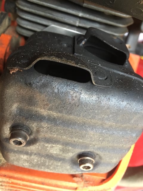

Just a nice subtle mod on the 394. Cut the deflector off to remove inner piece and solder the deflector back on. I think it should be enough. [emoji1360]
That's just what I did with the 3120 but it bolts on.

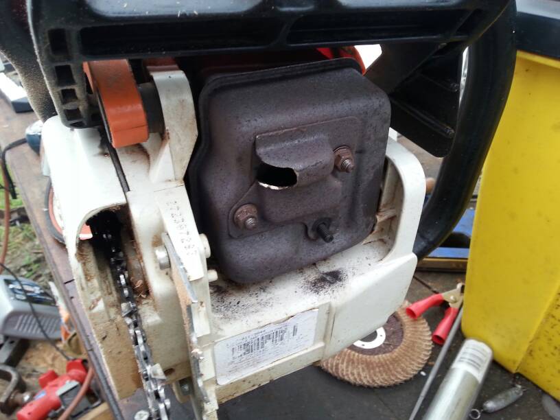

Nothin fancy wanted to keep ot stock looking. Did it ever make it stronger. I retuned and then put tach on. It about 13500 with a litlle gurrgle out the cut.
