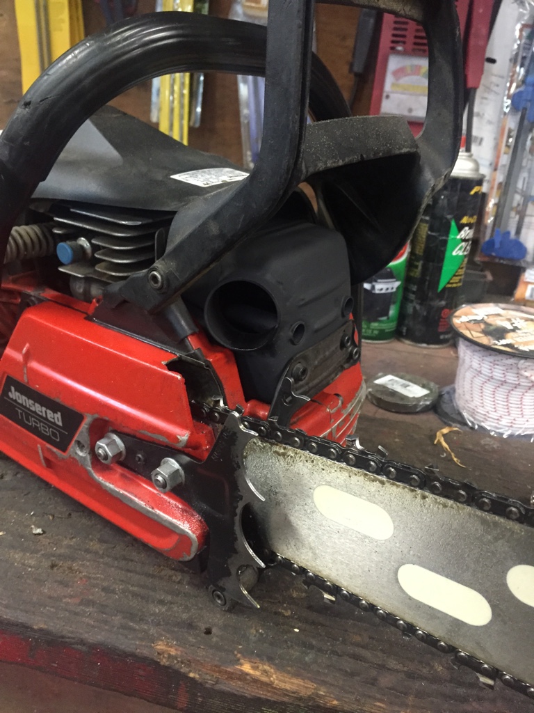

I try to keep my muffler mods looking stock or with just a added deflector.
This one you wouldnt know it from stock if you didnt look under oem deflector.
Baffle removed and exit opened.
