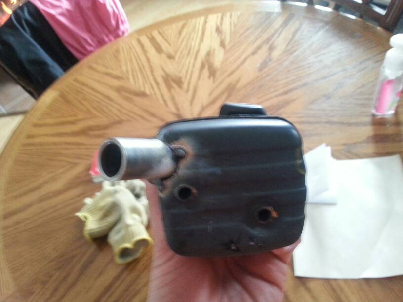

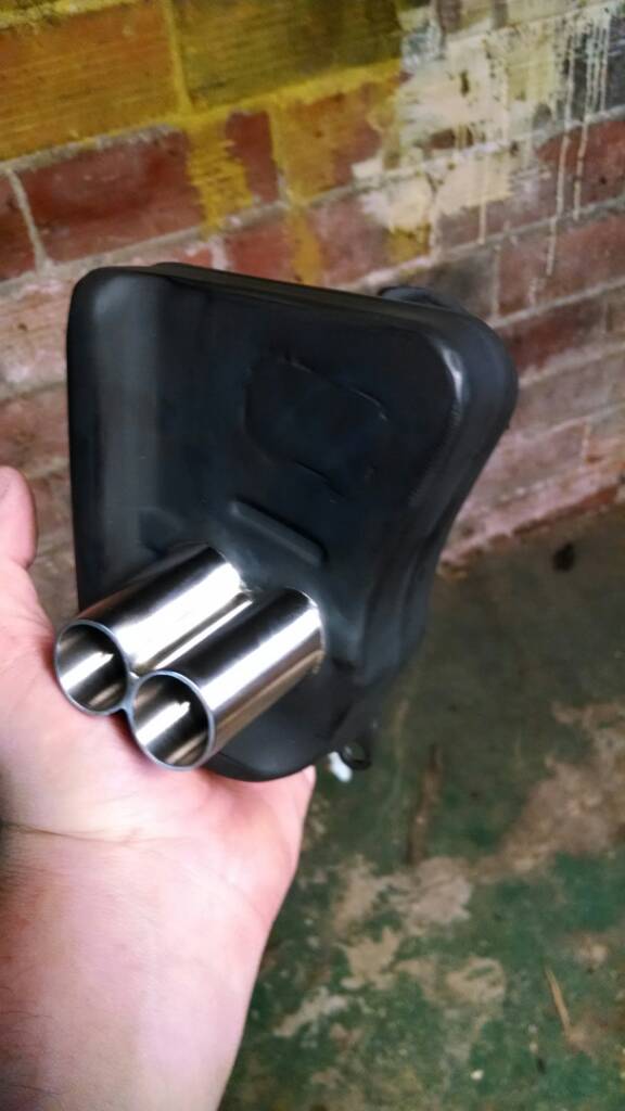

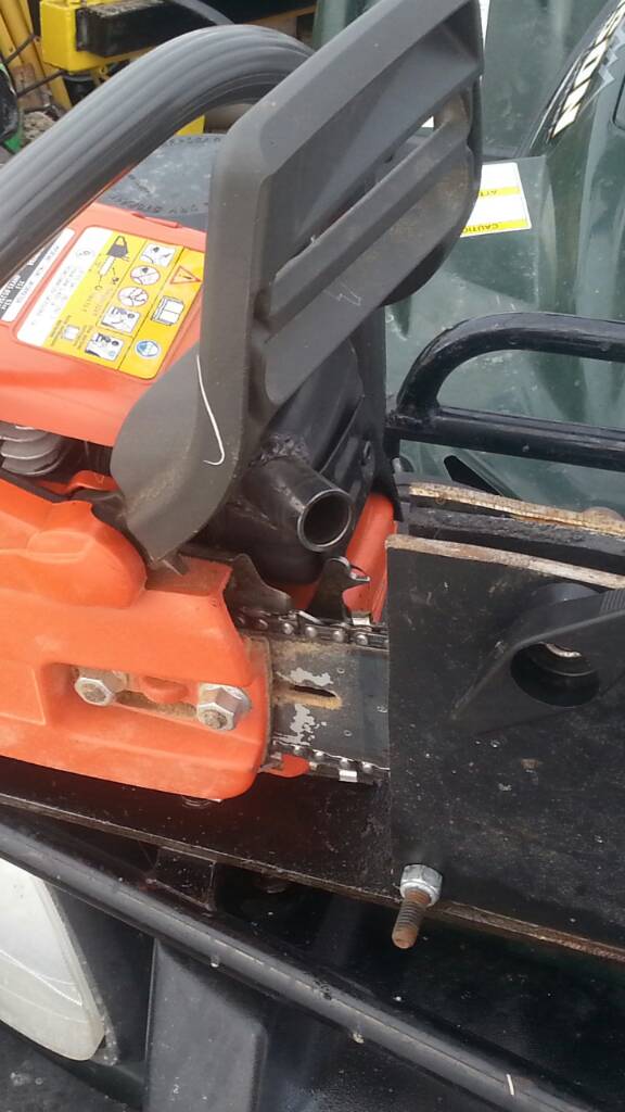

Holy crap!! That's huge..... I put a 25/64 inch hole in my muffler and I didn't want to go much bigger because I thought it would be too loud.
I use the same 1" pipe on stihl mufflers with a gutted dual port cover to boot.
1"x2" hole in the cover plus the 1" pipe on the side. Very loud though.

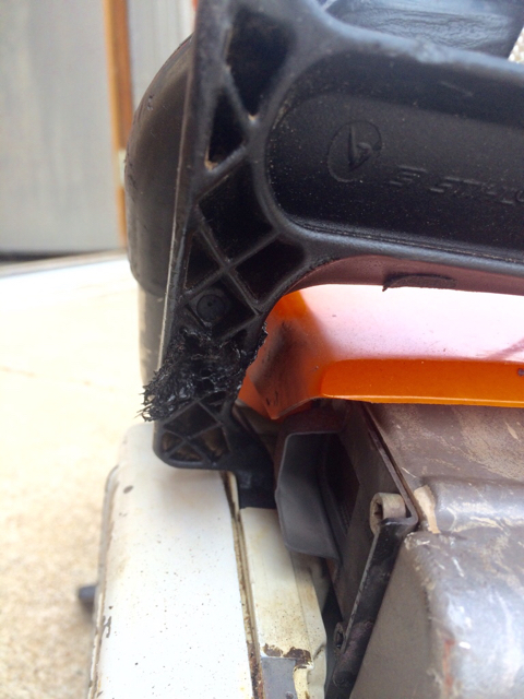

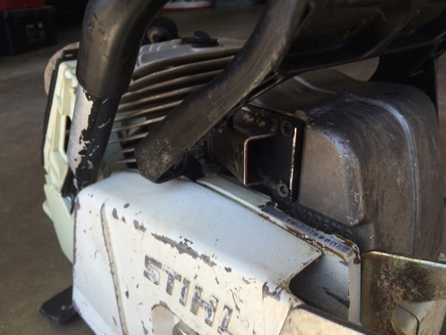

MS880 w/clip on muffler.
Original outlet hole about 9/16".
Dremmeled out a bit.
Old deflector removed and a slice of 1"X1" tubing to carry exhaust foreword.
Without the deflector we nearly burned the brake flag off.

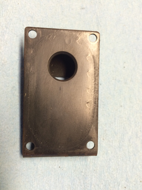

I made the above over large as all I need is some shim stock to make it smaller.
