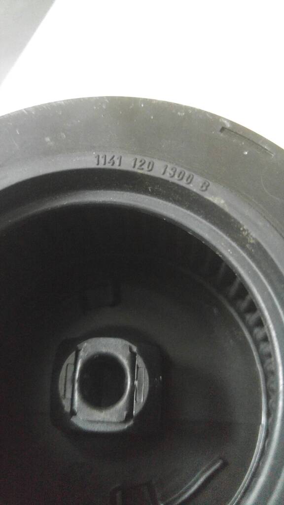

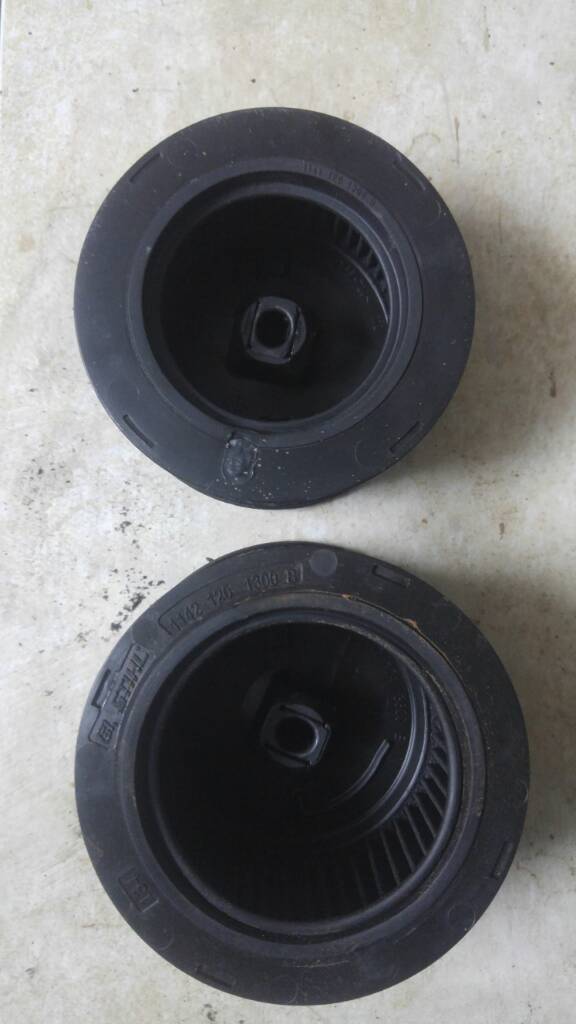

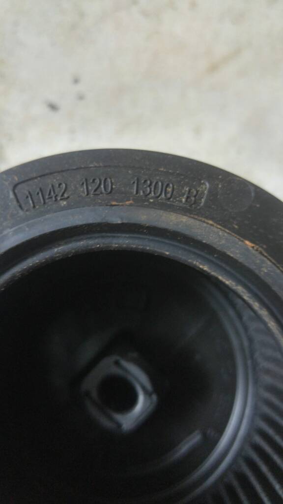

So ...these are the normal HD filters. Tje small one fits MS241 271 291 261 362 and the bigger one the MS462

I'll check later the part # for the 241-261-362 and the 462.
Be careful Iceboy. The part numbers on the filters in your picture are not the valid part numbers for ordering. It`s often the case that on the part is a other number as it is listed in the system or the IPL.
Part number for the HD2 filter of the MS241 271 291 261 362 is 1141 120 1604.
