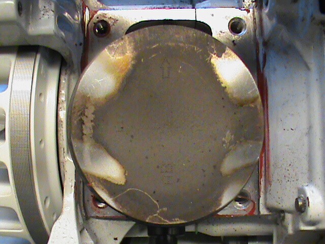

Here's your first piston wash -
And here's this last one for comparison -
dsc01240-jpg.106998
It looks like you may have shifted the primary flow a bit more to the center, but there is still a fair amount of short-circuiting going on. That exhaust port just keeps wanting to pull the intake charge out of it.
When you said "epoxy time", where are you going to add the epoxy?

Odd thought but do you use L and R cutters for the transfers? Without the jug in my hands I’d say there are discrepancies between the sides in shape, volume, angles etc. The whole temp difference is hard to swallow without some experimentation.

any thoughts on the pics?
dsc01240-jpg.106998
Looks like the flywheel side is aimed upwards more, ie: roof is not as flat, but also Making a quicker exit, bouncing off that bridge
dsc01240-jpg.106998
in the back of the primary next to the tr bridge

rh cutter only
What’s your PayPal? I’m sending you some $ for L cutters. I’m curious to see if it makes a difference for you.
I don’t want to fund the R&D as much as @Redbull661 but I think a 461 might be the one Stihl I’d be happy to own. So if I can help you out before I go balls deep with a saw that’s good for everyone.
