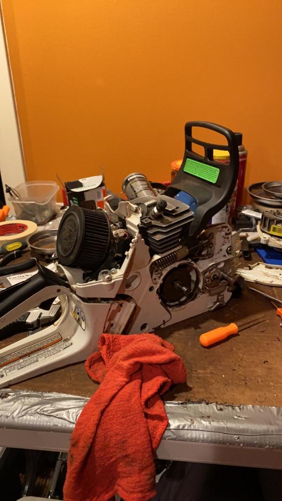

While you are checking obvious stuff, make sure the winter shutter is in the summer position so it isn't drawing heated air from the cyl fins....
Also never hurts to go thru the saw, blow it out, give it a thorough cleaning. That's s.o.p. for me when diagnosing saws. Just my opinion, ymmv.

Yes it went through a complete tear down. I’ve landed on new gaskets in the carb and doing crank seals. Cheap insurance.
