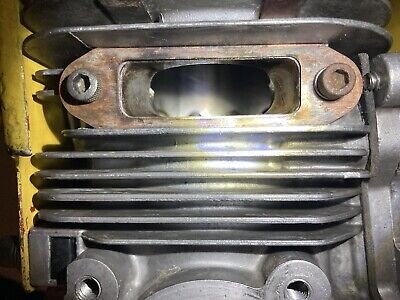

What do these pictures tell you?
I think I bought an mc101b. Not sure, though. & the unit is still in the mail.

Welcome to ope! That appears to be a 101aa, possibly a 101a the 101b had a recessed exhaust gasket. Not much difference between the blocks in all reality. Except the mc101
Well thank you, Bigmac!
This thread prompted me to join. Lots of awesome info here. In the excitement of waiting on the engine to arrive, I started reading, the exhaust gasket caused suspicion. I don't actually know what the recessed unit looks like, though. That & the yellow cowling. The ad read that it's a 101b based on a NEW shortblock, whatever that means (again I dunno enough yet, but hopefully it means NOS ). Going to have to get the crank machined. 3,300 miles from here there's a waste basket that contains a complete cp125, possibly an sp125c that I'd like to use. I messed with it in highschool & thought it had a chrome bore, not sure though. Either way it's 1st string candidate.. I got it for free from a schoolmate's dad, so. I have a super 797 in another waste basket. The 795 I rebuilt a number of years ago made it out of it's waste basket. They make good storage units for torn down chainsaws, if you have an excess of them! Like you mentioned, the 101 engines are similar, so if it's solid, I'll be very happy.

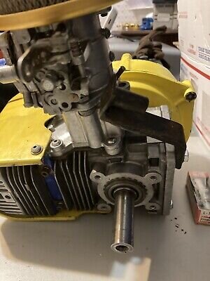

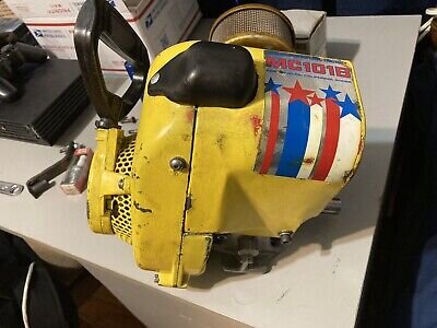

Here're some more pics. I assume some of you may be familiar with this unit given where It was purchased from.. s-l400 (2).jpgs-l400 (3).jpgs-l400 (4).jpgs-l400 (5).jpg

I was gazing at the pictures & it appears that the yellow is a 2nd coat over what looks like red on the head cover as well as the flywheel shroud.
The interesting part is that the yellow appears to have been brushed on. Looking closely, I can see where the 101b sticker was painted around. There's a knick in the sticker with red underneath. Not sure about the red shroud. Frankenstein status probably. I'm excited.Screenshot_20230402_172129_Chrome.jpgScreenshot_20230402_172233_Chrome.jpg
The interesting part is that the yellow appears to have been brushed on. Looking closely, I can see where the 101b sticker was painted around. There's a knick in the sticker with red underneath. Not sure about the red shroud. Frankenstein status probably. I'm excited.View attachment 372327View attachment 372330
Good catch, haven’t seen a red factory fan shroud, so the 101b had a metallic red rear cover and the 101mc had a straight red with white fan shroud. The crank looks like the 3/4 101mc crank
