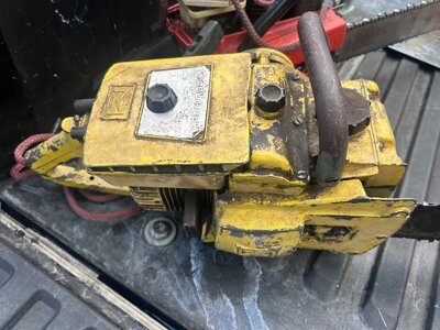

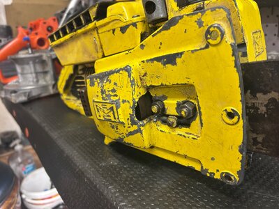

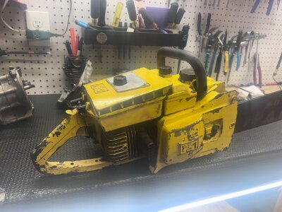

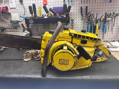

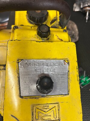

I come across a McCulloch 200 when I went to pick up a dolmar 122s. I can hardly find any information on this saw. What I do know is that I need an oem carb kit, McCulloch bar .404, choke linkage, possibly a fuel line (my misc box has nothing remotely the right size), possibly a set of dogs.
Love to hear y’all’s stories, knowledge, information on this boat anchor 😂

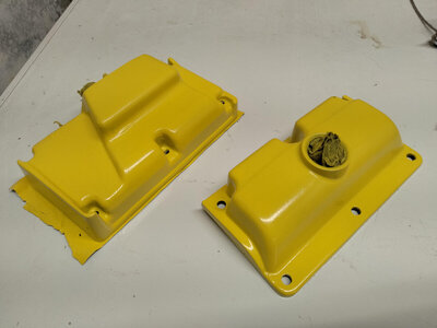

Below is a picture of my oil tank, it had a bunch of pitting, so I cleaned it up, dremmeled any metal rot, filled with bondo and JB Weld, primered and painted. I am waiting to get the entire saw completed and then I will hit it with an automotive clear coat with hardener to help protect it.

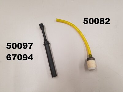

The McCulloch 200 is an 80 cc saw, manual oiler only, and were normally equipped with a Tillotson HL carburetor. Tillotson DG5 kits are generally easy to find and should not be too expensive.
The fuel line is a two piece affair, the one in the tank is NLA but you can substitute generic fuel line and a weighted filter in the tank. I have some fuel lines I've put together from 1/8x1/4 Tygon that I "bell" the end to make a better fit over the nipple in the fuel tank. The original 50097 external fuel line was replaced by 67094.
I have most of the other items as well including rings, seals, gaskets, and most parts.
Mark
Thank you sir I tried the dukes 2.5mm and echo 3mm fuel line I keep on hand in bulk plus misc everything I tried I couldn’t get over that massive nipple. I added a few more parts to the list if you’d be interested in selling or swapping parts (if I have any thing of interest) I’d rather it go to someone Helping me learn than just a company online.
