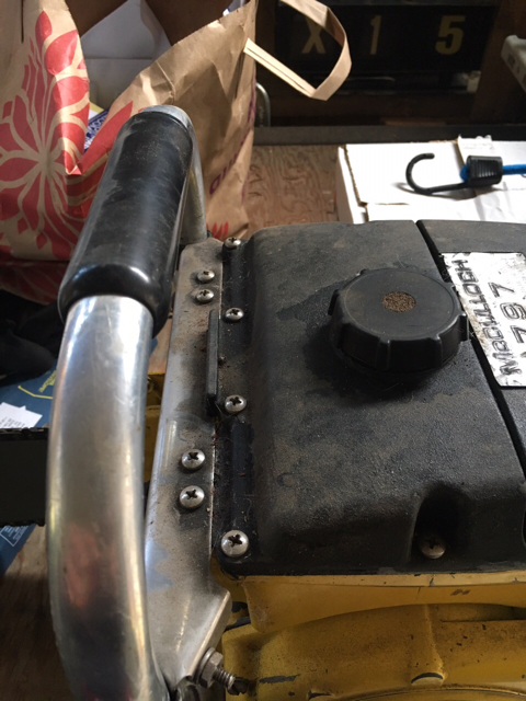

Curious if anyone can help me out with this handle crossbar? I purchased a couple of these and the mounting g holes line up with the mounts on the 797 and the length is correct in relation the the bar width, but I am curious if the width I am measuring matches up with the width on an original 797 crossbar? Would anyone be willing to measure there bar for me and let me know?

I have one that is Carbon steel and one that is Stainless. Anyone have any thoughts on that?

Discard the rubber mounts as the 797's didn't use them. 795's did and not sure why
although I have some with the mounts but according to the ipl's I have 797s don't
have them. Your brace will mount directly to the fuel tank.

Do you notice any less vibs with the rubber mounts, I realize they aren’t correct but do they help? I added them to my 797, and vibs seen less, but if lower mounts crack more often the I would swap it out. I have hear guys say a 797 is a white hand saw from vibs, mine isn’t that way

I've never run one all day, Just here and there for my big logs and gtgs. I would guess with any
rubber type mount it is going to absorb some vibration and your hands should notice a liking
at the end of the day. My guess as to why Mcculloch didn't offer them on 797's is because they
are more of a pro fallers saw or landing saw where cutters were looking for the most power
and wrenching on the saw with the dogs. The mounts may not have taken the betting and once
they are broken the wrap handle is only held by the lower mount unlike an SP125.

From my observation I think the sheer weight of the reeders takes the shake out of them .Something like the later lighter weight 10-10 series can rattle the teeth right out of your head .Then again some do and some don't .
