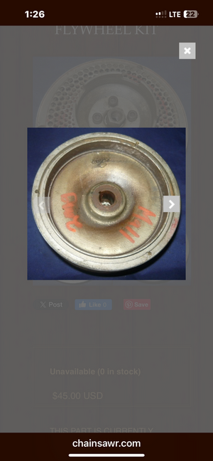

This one here is off a 2mg, mine is a slightly different shape, less of a lip on it but there’s no pictures of it online, it has 2 or 3 cracked fins but it has a lot of them

Is it all steel? or a cast pot metal? I cant believe its steel or any ferrous metal as it will interfere with the magnet/coil
If its pot metal/aluminum the magnet is in the outer lip somewhere, might not be obvious. You can find it with a magnet...if its not all steel :rolleyes:.
