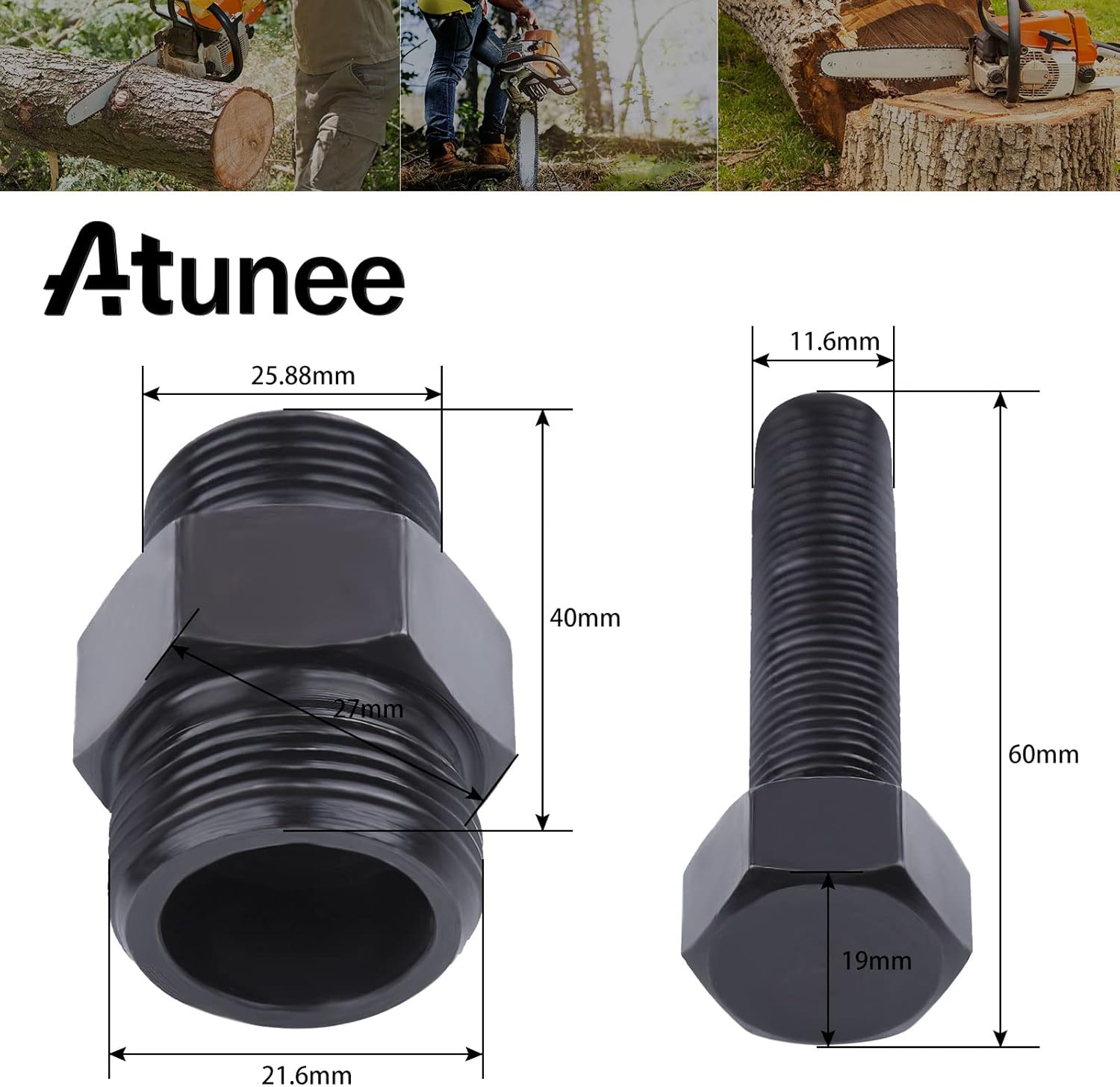

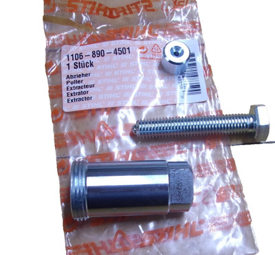

Hello, I wanted to make some tools in order to work with chainsaws (and other equipment as well). Many of the service tools are so expensive, and I thought that I'll make them myself instead of buying them from dealers. The only problem I have is that there's no specs for the tools like the one Stihl 1106-890-4501. So basically I'm looking for the specs of the most common flywheel pullers for Stihl equipment (and possibly others). Does any one can provide me with some info, i.e. thread sizes, and other dimensions concerning Stihl flywheel pullers or other similar tools? I already made myself a set of the tap pullers based on this thread.

Looks simple enough to make unless You have to buy needed taps & dies, then it'd be cheaper to just buy the tool itself

Hence the pics I posted...............

If someone has one of the tools, all I need is thread sizes and dimensions. Making the tool wouldn't cost more than $1 for me (shipping included)... :D
What's the two external thread sizes of the tool on the left?
