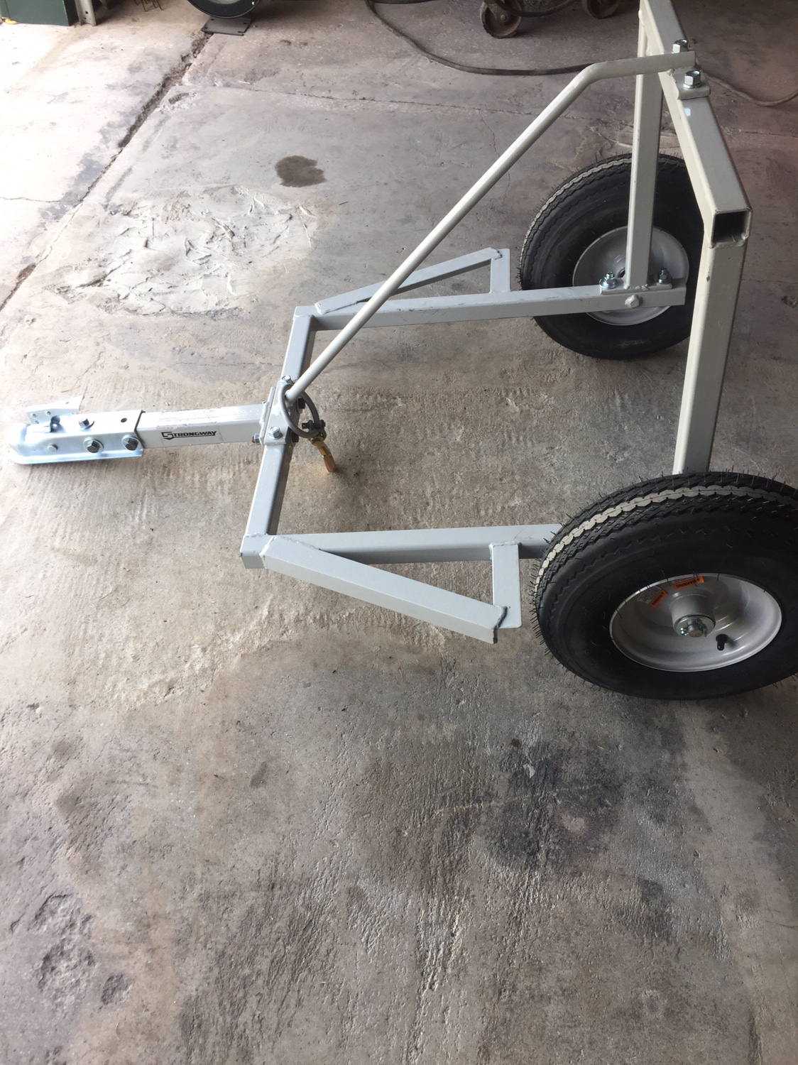

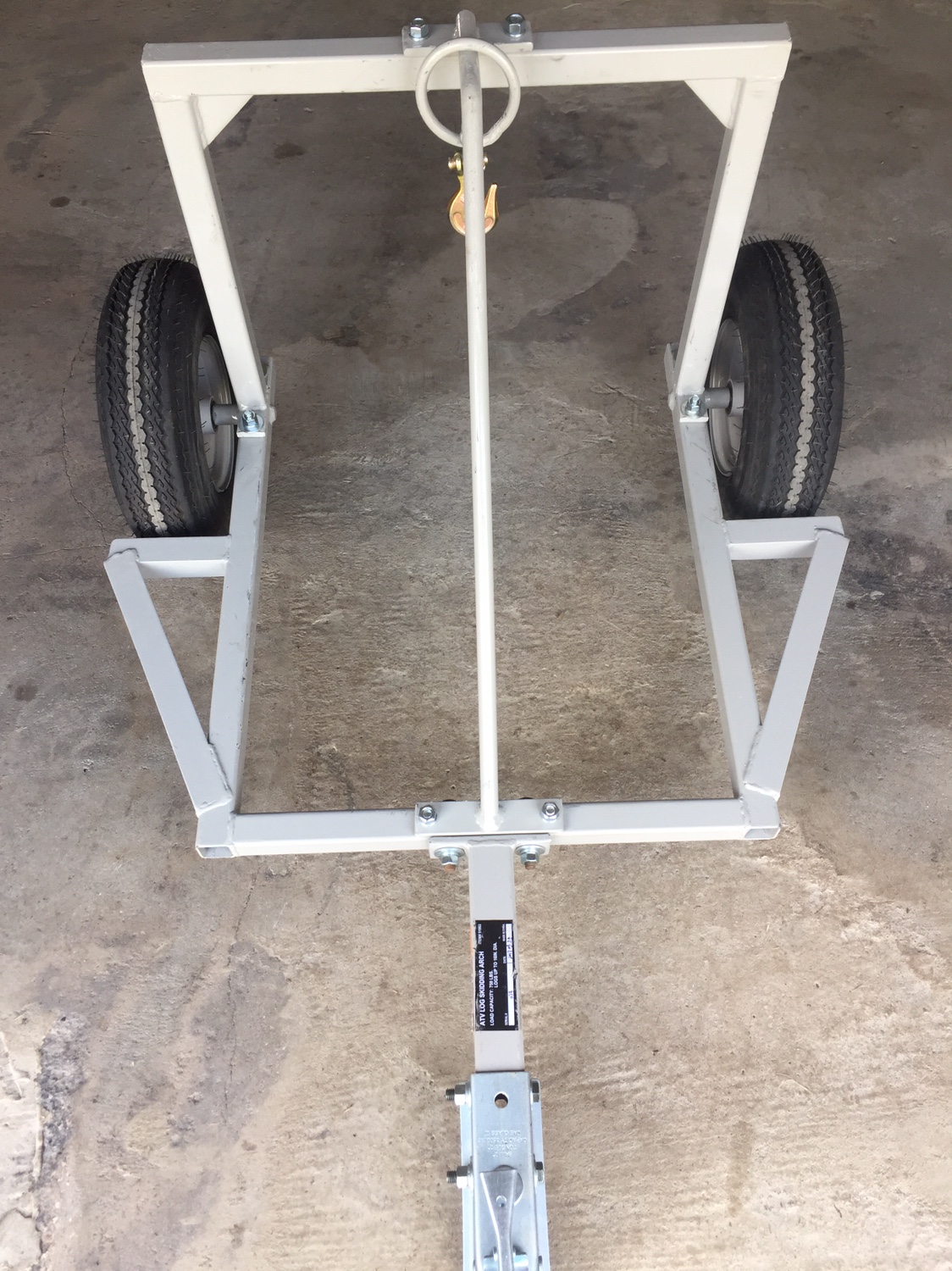

Here ya go boys all done welding. Just waiting for paint in the spring. Much happier the way it come out now, all I have to do is weld a couple log chain hooks onto the back so I can secure the log while transporting. I'll have to wait until spring to get some paint on it. unnamed (1).jpg unnamed (2).jpg unnamed (3).jpg unnamed.jpg

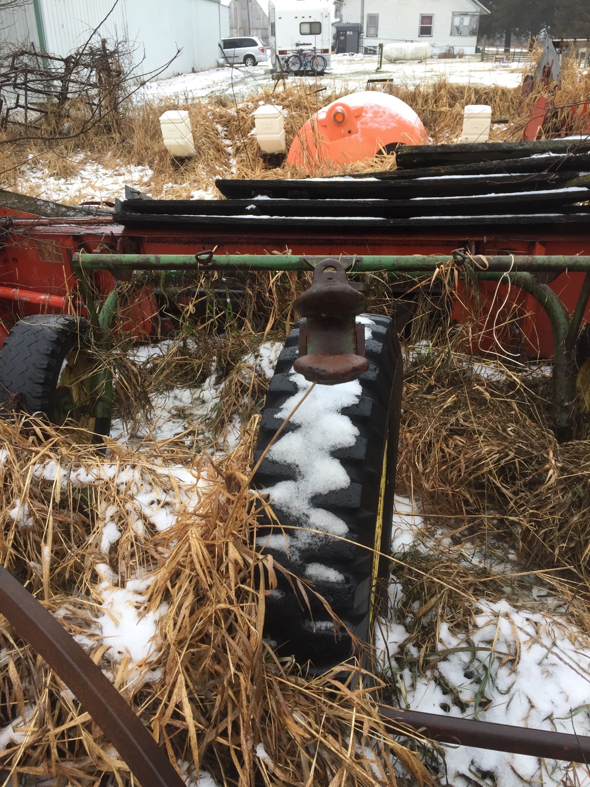

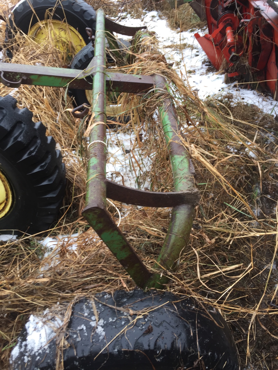

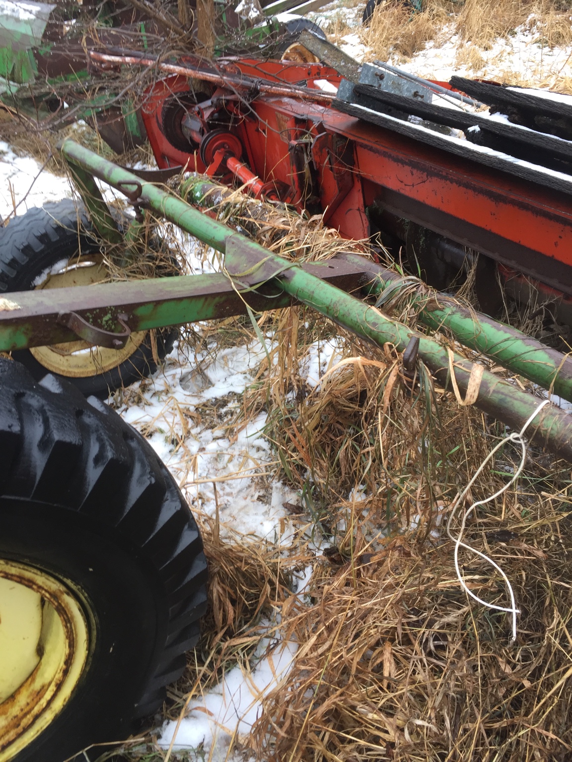

This is what I was thinking about using. Old sprayer frame.
Was froze down so couldn't move to get better pics.
Sent from Hoskvarna hills
