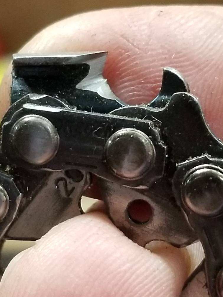

It's not race chain but I converted one of my 20lpx 325 chains this afternoon. Needs some clean up, but I'm tickled with it

Picco is supposed to be a no no. But...
You should get Picco skip and practise...lol
That doesn't look very familiar for a work cut to me. J/k
Looks like you can shave skin of your fingers with that.
Is that a grind or hand?
Don't you damage the cutters when you doctor it up further or did you just do one tooth?

Yesp, sharp enough to shave with. Did the whole loop. More to come on it. Gotta be gentle with picco

Thanks bud. I did it with the vise-grip locked in the bench vise ,one tooth at a time, John Riley method. Works well. Yeah it's a little tight but doable.
Crazy I thought it was a grinder. The two biggest problems I would have with that for cutting trees.
I wouldn't get that half second or second rest on my front arm every time I had to brush out the sapling and I would be blast through the hinge on 3 ft trees.:cheeseburger:
*Edit I missed you post and pic. (I see It now.) I though You & Jeff were talking about you filing Keith's chain. looks like a solid work chain.

Grind
Gotta make it cut good before ya bother with the chassis
Looks solid.
I edited in last post. A bit of confusion on my part.
Good stuff.

No worries bud. Thank you
I forgot what I was going to say last post.
In regards to holding each tooth in grips in a vice.
first tri file I used was holding the cutter in my fingers and It was on round chisel in a hotel. just had to try a few out.
Should see some coast fallers file on the hill. Jam the bar tight between two logs with the power head straight up in the air.

I bet that was interesting trying to hold it in your fingers lol. I can maintain a chain on the saw ,but not doing a conversion from round to square.
