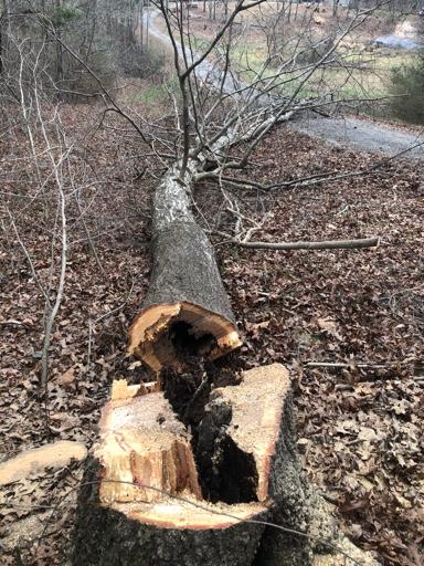

Bad leaning Red Oak that was rotten in the center.
I bore cut it & left a larger than normal strap because I knew there wasn’t much left of it.
Turned it a bit & pitched it down the hill in the general direction it was leaning.

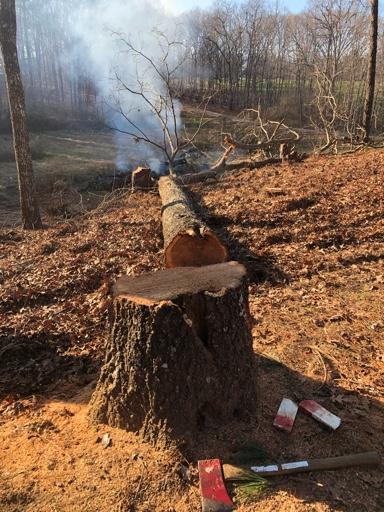

Same thing but with more stable heart wood & less lean.

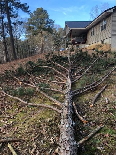

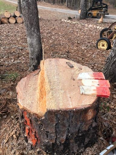

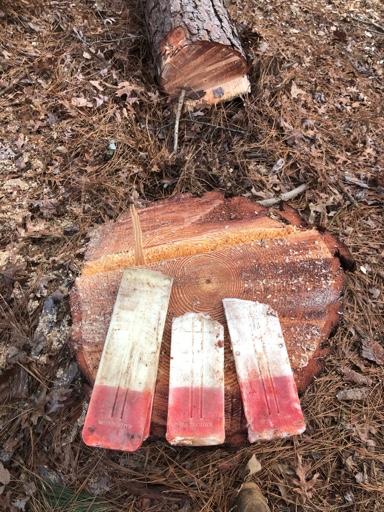

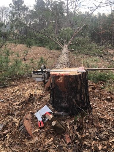

The rest of this job were Pines.

That top one makes me nervous and I did t have to cut it.
It was out over that driveway a good bit & leaning hard. I was able to turn it a fair amount with the face & bore cut.
Years ago a well was dug & a water line put in on the back side of the tree: it appears the roots were compromised then & this was the outcome.
