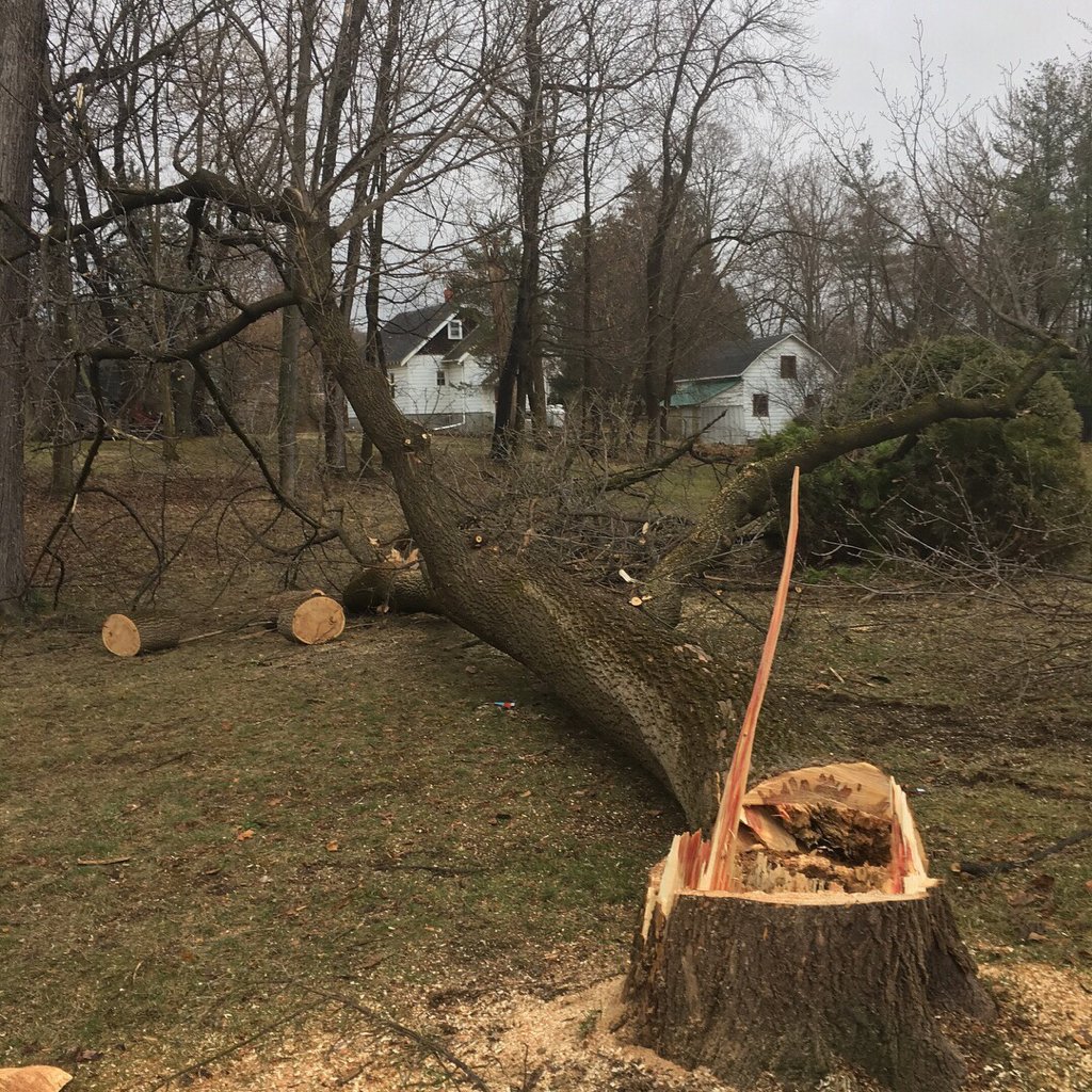

Just snuck this one in to get it on the ground tonight so I can just clear it tomorrow morning. Bigger silver maple. We call them swamp maple here also. Got dark quick. Won’t do that again. Anyway I might get flamed for this a little but I have used the “triple hinge” 3 or 4 times now with good success along with wedges. Seems to help steer the tree. Anyone else try it? I am a novice and have a lot to learn.
