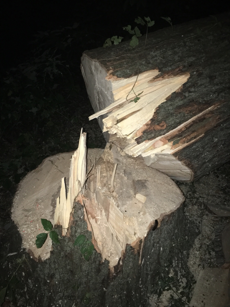

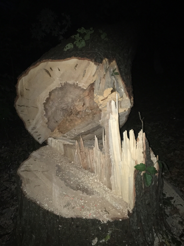

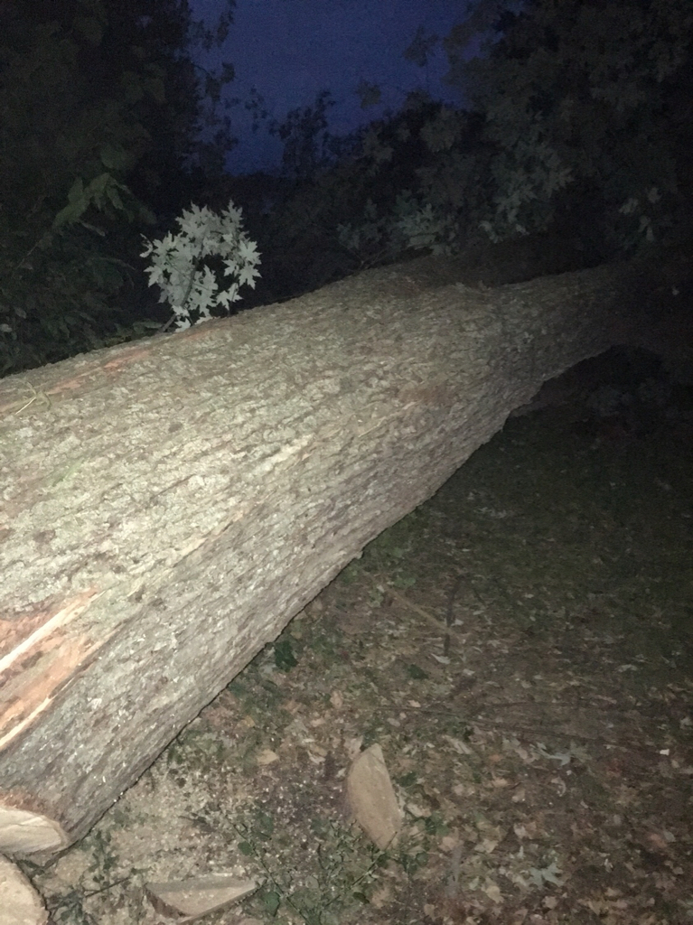

Just snuck this one in to get it on the ground tonight so I can just clear it tomorrow morning. Bigger silver maple. We call them swamp maple here also. Got dark quick. Won’t do that again. Anyway I might get flamed for this a little but I have used the “triple hinge” 3 or 4 times now with good success along with wedges. Seems to help steer the tree. Anyone else try it? I am a novice and have a lot to learn.

Wow, big tree! Nice job.

You might try a siz wheel if done right it’ll pull a root out of the ground. Almost looks like it released early from the stump because of the Dutchman, how much swinging of trees have you done?

Yes it released a bit early. It was leaning a bit, I just wanted to get it more to the right where the field was more open. I'll have to look up a siz wheel.
