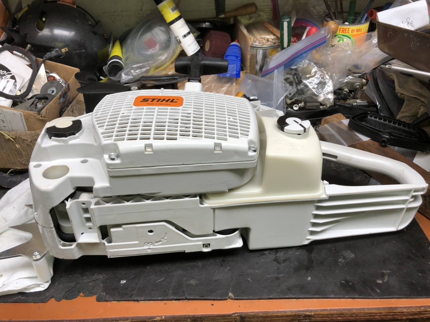

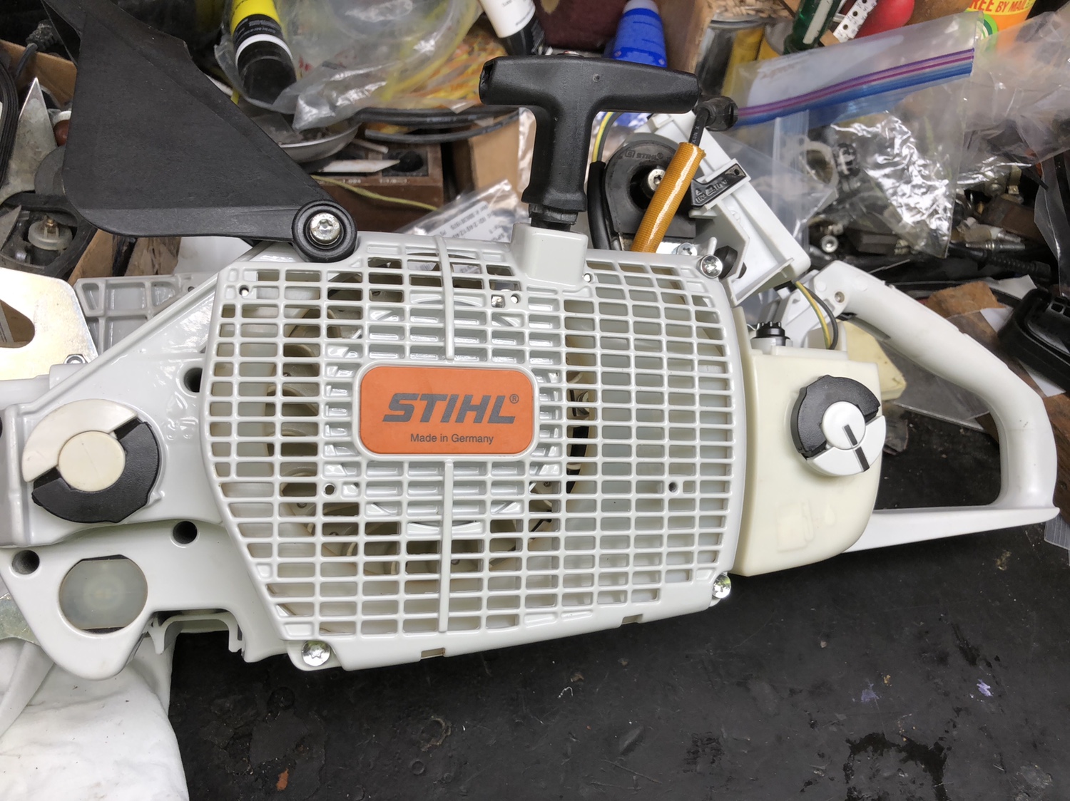

My 880 before shipped to tenn to get molested
Shaun does some kind of awesome work
