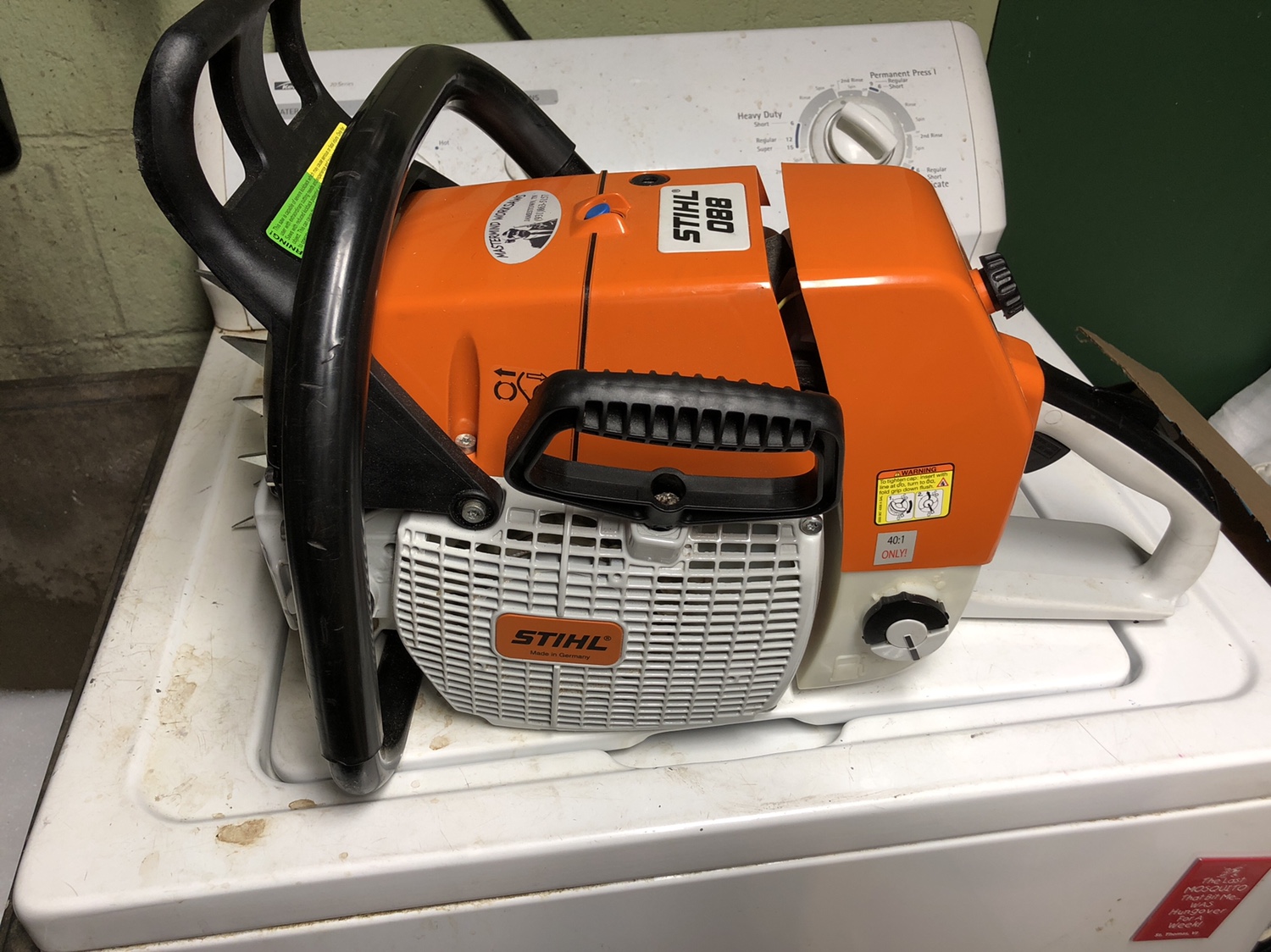

Just another MS880 build.
Lightning Performance
7:45 AM
677
Jan 26, 2016
10,991
28,060
East of Philly
Nope. I don't own a degree wheel nor would I take time on a stock work saw.
Running it...I've run enough big ones it's lost the fun factor. That one I have run a bit and unless that 42" bar is buried its not that impressive.
I ran two stock ones with 36" bars and one with a 31". Unimpressive and too heavy for my taste.
The owner of the company is the only one to run that saw. If I guessed a crane pick swung in or leaned that way and got it. Normal use is flush cutting stumps or when lifting large crane picks.
That crane seems a likely opps deal. Or....*s-word happens.

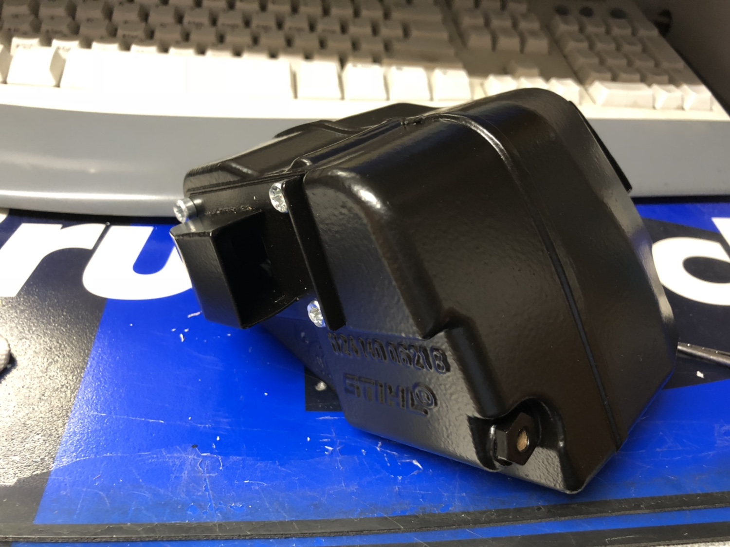

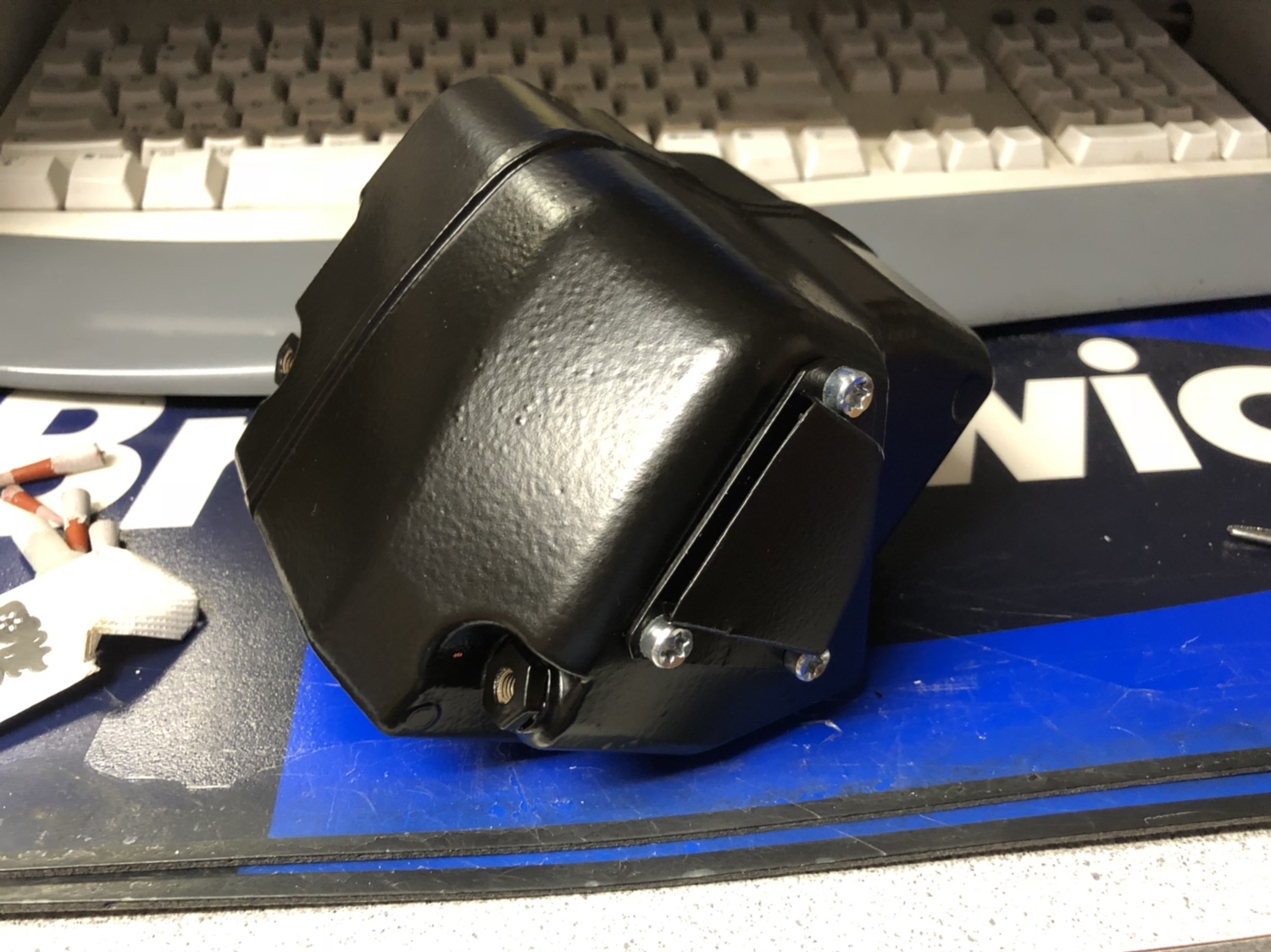

Is that the exhaust? It looks like one of the cast-iron exhaust risers on my marine GM 350! :eeek:
Yes thats the muff
Shaun Carr did the metal work we hi temp powdered and the saw too
