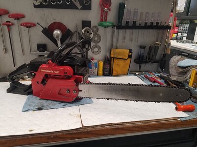

Thanks to el33t I bought the LRB piston for the 451E, piston arrived yesterday so I put it back together today. Everything works just as it should.

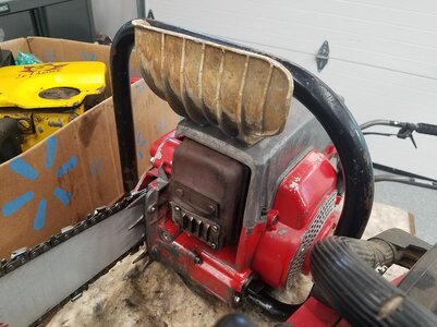

This one came back with me from Oregon, I guess they had a "West Coast" muffler set up for these as well.
The 451EV I finished during the week had a completely different muffler with the square outlet.

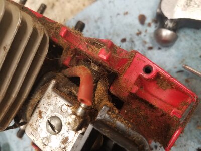

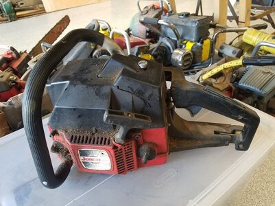

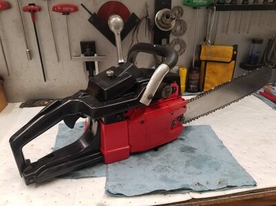

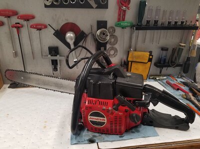

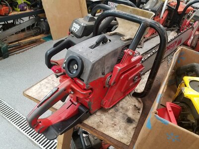

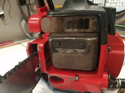

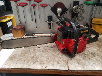

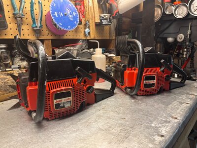

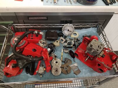

We also went through the 520SP today to prepare it for the display. I will have to say, compared to the 49SP this one is a lot more Semi and a lot less Pro...
The 520SP was dirty, but did have spark and adequate compression.
I should have taken a few more photos as we had this one down as far as the cylinder and spacer block off so I could replace the impulse line. The red silicone line just wasn't going to work out.
New fuel line, vent line, and impulse line. I went through the carburetor to be sure all was in order, in the end the 520SP is working as it should.
I realized as I was finishing up it is missing the brake handle and some bits under the clutch cover.
bucketoguts - this one is equipped with an 8T .325 sprocket and of course .325 pitch chain. I have not investigated much on these smaller Jonsereds saws but I haven't seen any full 3/8 pitch sprocket nose bar to fit, only 3/8 LP and .325.
