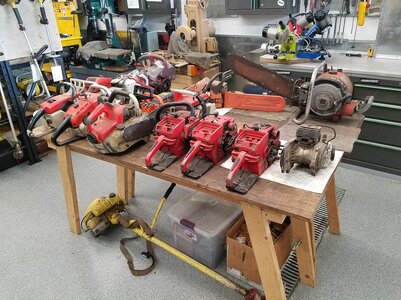

I have three parts saws in the attic that Chris Lehman brought during the open house in March. I will see what shape they are in, if I can use a piston and cylinder from one of those I will. I will let you know what I discover.
Thanks Jay for all of your continued assistance.

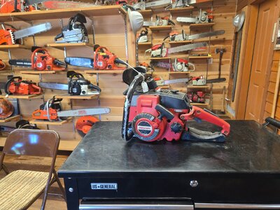

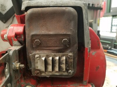

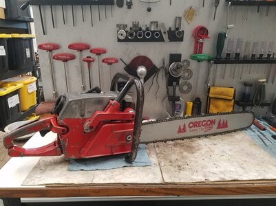

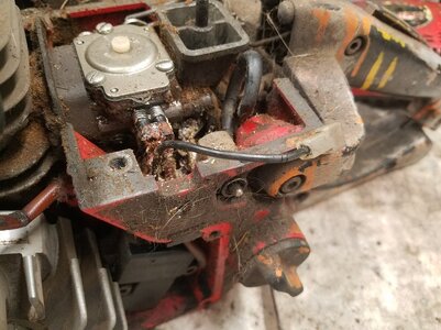

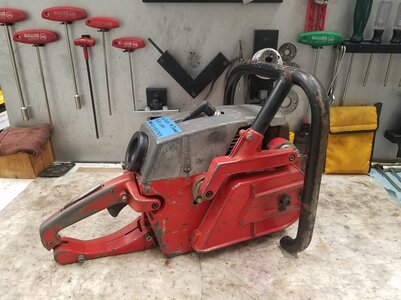

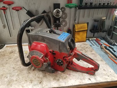

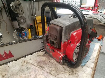

Here is an 80 that I picked up from Marshal Trover at the PNW GTG last month.
Judging from the photos on Mike Acres site, I think the muffler is wrong for the 80.
I have this one torn down far enough to give it a very thorough cleaning.

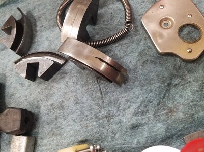

I have never seen a clutch so badly worn, the shoes are so thin that it actually has worn through into the spring groove in one place, one broke when I tried to use the Jonsereds clutch stop tool to loosen the nut, and you can see another is cracked.

Mark I believe that muffler was usually termed a "West Coast" muffler perhaps supplied along with the full wrap or as a stand alone option to the standard muffler with the square exhaust. I've never seen one dealer fitted to an east coast saw but have several of those mufflers that all came from the PNW. They are very open compared to the standard.
Wow!! I have never seen a Jonsereds clutch that worn out!! Wonder how many drums it's been through ??

My 80 has a square outlet like the 721 ect had if I ever get around to doing anything with it. The 1010 pro mac is a pretty torque laiden saw for the size of it, runs very nicely.
Still will be searching out a 700/750 or other large mac just because I want one later.

Apparently some 80's came with that muffler. There's 2 pics of 80's with that style muffler on Magnus' site.

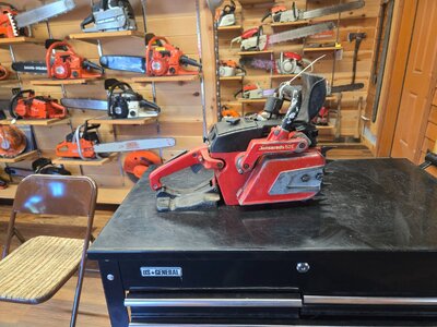

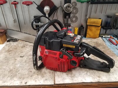

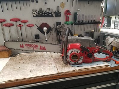

I was able to get the 80 reassembled today, starts, idles, run, and oils as it should. While reassembling I realized I didn't have the clutch bearing and spacer...as I thought about it I don't remember seeing it when I took the saw apart and it seems unlikely that I could have lost them overnight. Turned out no problem as I still had one set left in a box in the attic, most likely from a 621. The three shoe clutch worked and I was able to repurpose a 24" 196 mount bar just to have something to finish it off for now.
I expect it is unlikely Jay, but I would like to try and find the two hand guards (top mount and rear handle) to finish this one off.
I looked at some You Tube videos and saw that Mike Jensen (Saw Hoarder) had a similar muffler on an 80 that he had.
As tempting as it is to take this one out and put it in some wood, I think I will just find a spot for it in the display.
Mark

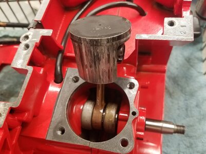

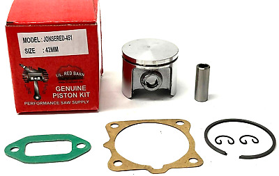

On to the next project, 451E. Does anyone have, or know where I might find a piston (PN 504 41 00 04)?
I think the cylinder would be O.K. but the piston is beyond hope.
My other option is just put it back together and add it to the display, which is my intent in any case.
Mark
Aftermarket one:
The seller (from VA) is rather reputable.
or maybe:

Thanks for that, I was only searching by part number and that listing did not come up...

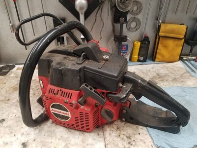

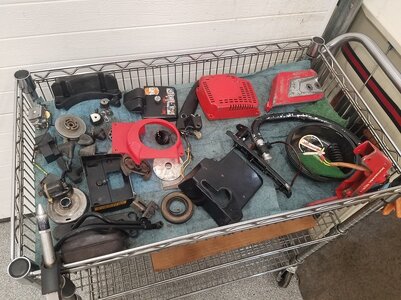

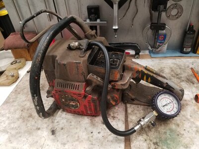

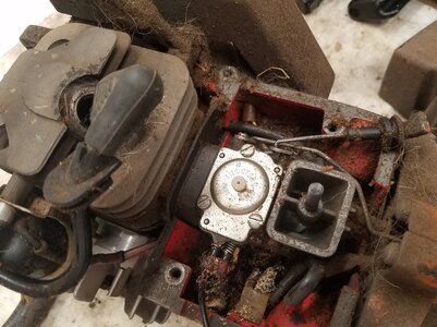

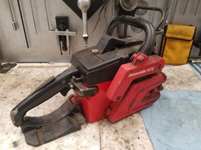

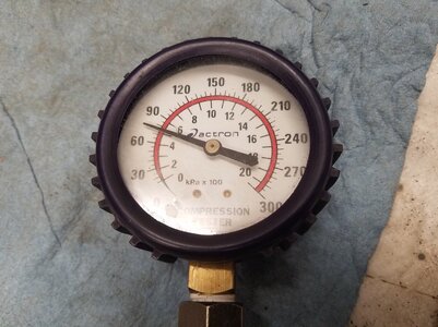

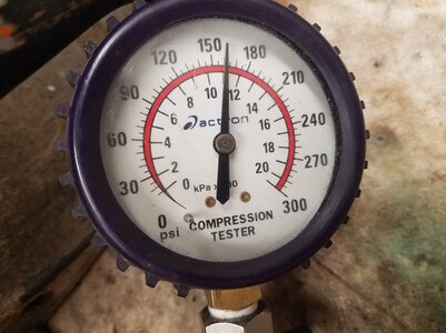

While rummaging around in my garage today I was reminded of another small Jonsereds up on the shelves, turned out to be another 451. An absolutely filthy saws with slopped paint and dog hair thrown in just to complete the ensamble.
On the other hand, spark and compression are quite good.
My first thought was to use the piston and cylinder on the 451E that I'd started on yesterday, but I noticed as I was disassembling this saw that it has heated handles and is actually an 451EV.
Mark

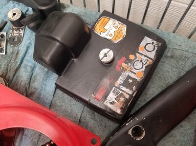

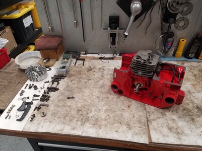

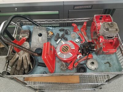

Cleaning continued today. My son took over this afternoon while I spent some time taking care of my lawn. 5+ inches of rain this week along with some warm, sunny days make the corn grow, makes the grass grow too.
The only way we found to get the paint off was scrubbing with a variety of brushes (nylon, brass, stainless steel) in the parts washer with mineral spirits. I did stop short on the AF cover in order to preserve what was left of the decal.
I just got started on reassembly when I had to leave it for the mowing duty.
I try to lay the parts out in some logical order, makes it easier to find things as I need them and also makes it a little less likely I will forget something as I go along.
Mark

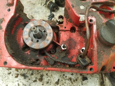

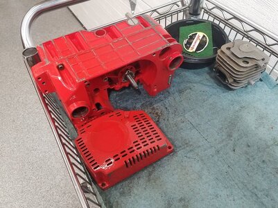

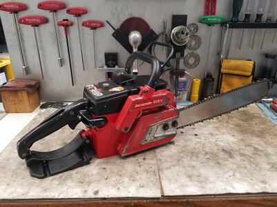

I spent a lot of time on other items today, but I did get the 451EV back together and operational. Radical transformation...
I will do my best to stick the decal back on the starter cover.
I didn't run it long enough to check the heated handles, but I will tomorrow. The wiring was in better condition that the 521E's that I recently went through.
