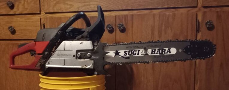

Put the 2065 on a Sugi diet. Save a whopping 10 Oz's!
Looks sexy. This is still my hardest worked saw. Runs an 8 pin sprocket yet ya could damn near stand on it without bogging it. I do have a jred sticker for the clutch cover just never seems to get there.

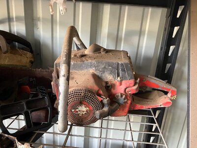

At a neighbor's shop I stumbled across an 81 or 801 I've seen before but thought was long gone, complete with a full wrap and H & S spike if I saw right. I didn't dig it out from behind the pile it was behind to read the sticker, though, since it isn't mine. Next time I see him I'm gonna nag the owner about cutting it loose.

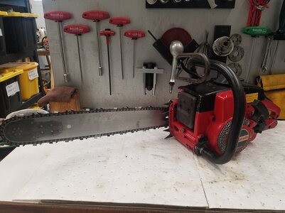

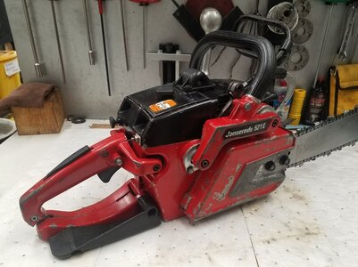

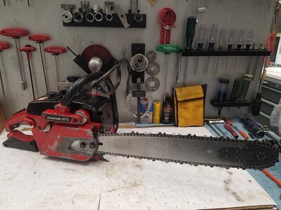

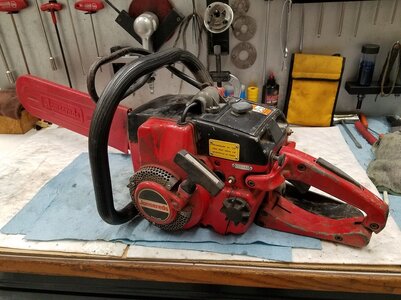

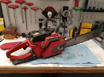

Last week a fellow walked in to my shop looking for some black iron carriage bolts for a spring board restoration project. As we got to visiting a bit I realized he was the Jonsereds dealer when I bought my first ever new saw, Jonsereds 621 in the fall of 1981...
I was able to locate some old carriage bolts and square nuts for him, in return he gave me this saw to do with as I wish.
The switches do not appear to be broken.

Nice! The red saws do have a tendency to breed. Heads up. lol

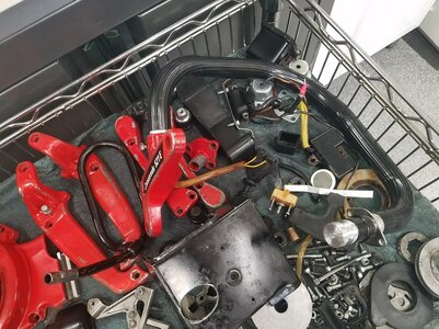

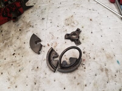

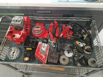

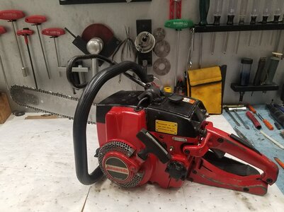

I got a good start on cleaning up the 521E today. When the clutch popped off, it really popped... I learned a trick from cbfarmall, get one spring started in a shoe and clamp it in the vise as you work the other two into position.
Everything is looking pretty good, except for some of the wiring. I will have to deal with that as it is going back together.

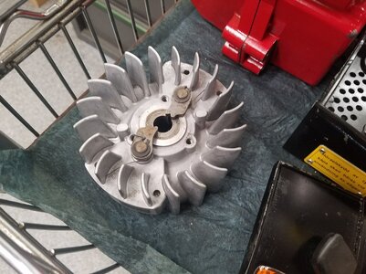

Lately I have been letting the flywheels soak in my bucket of solution used for cleaning chains (Mean Green and water) and I am delighted in the way they come out without having to do a lot of scrubbing.

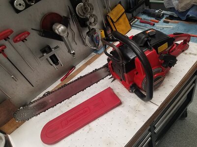

What I mistook for compression turned out to be some drag in the starter and flywheel. Saw is now fully assembled but lacking adequate compression to start and run. I will have to look over the parts saws in the attic and see if I have one with decent compression and swap the top end over.

So, Mark, it just so happens that I have a 52e saw that was a good runner but developed a hole in the gas tank. I've robbed the ignition, but everything else is there. It appears to be a low use saw and has a bunch of pretty parts on it. I could send any or all of it, if it'll get your 521 project back on track.
