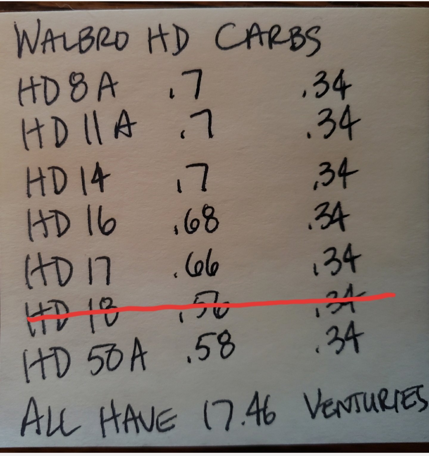

I wonder how an HD carb with slightly bigger main jet would run? More power?

Jeff, the jets can be changed, and I think Randy says he drills them, but the internal circuitry is supposed to be different with the HD-50.
But, I don't know the details, maybe someone with more knowledge about it can help out here.

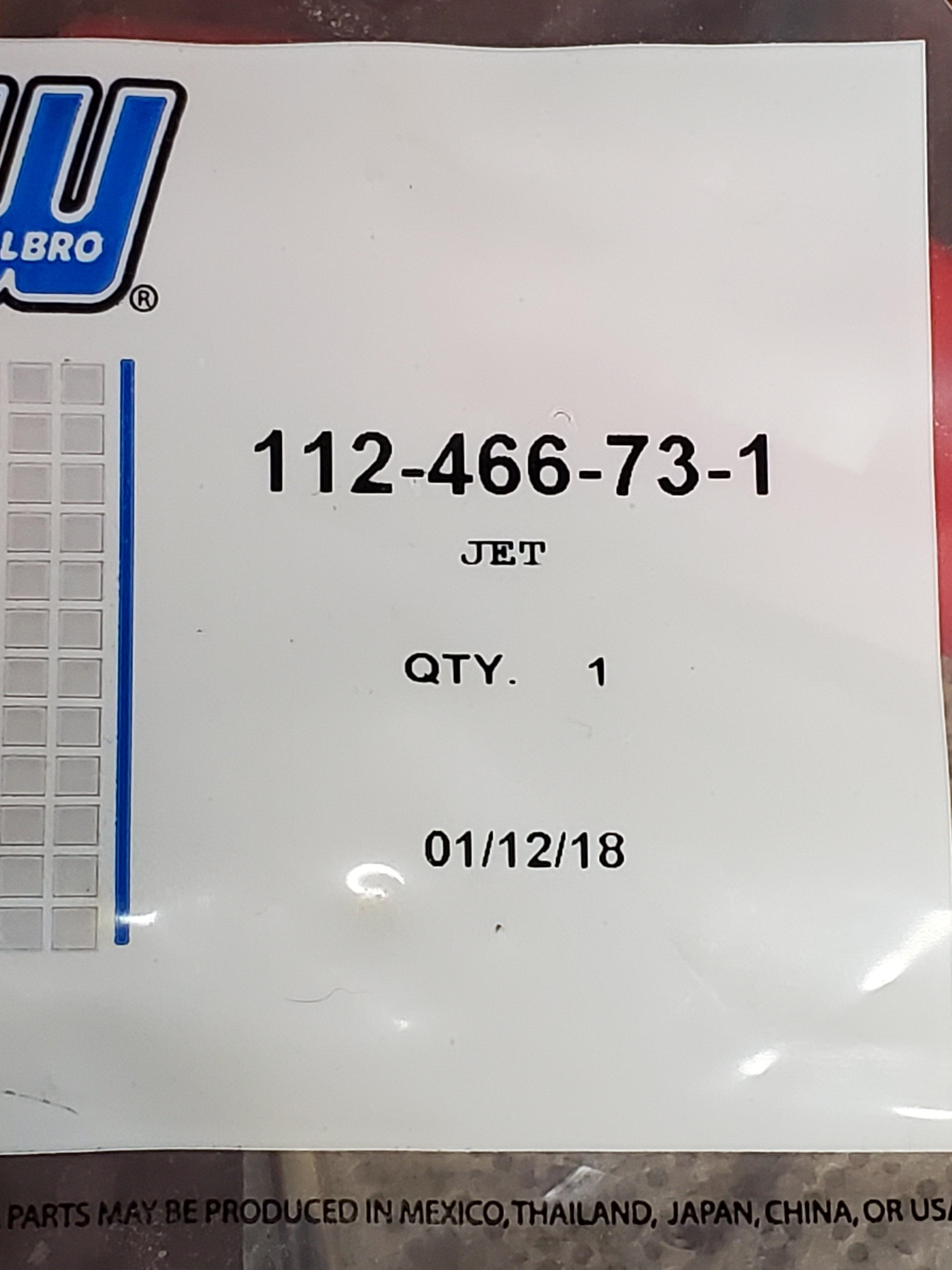

Just matters on how big they are drilled.
I still test the old fashioned way. Part replacement then put the saw in wood and see. Lol

Nice Dan. Did you notice the power increase?

The hd50 has a main jet that delivers x amount of fuel at wfo regardless of the H screw setting. The H screw just adds a small amount of fuel to fine tune the high side. They deliver added fuel as soon as the jet is cracked open out to about 4 turns out. Drill the main jet too big and the saw will always 4 stroke even with the screws in tight. Drilling the jet or replacing it won’t give more power, it just gets you back inside the tuning range of the h screw, like somewhere between the preferred 1 and 2 turns out.
To get more power or rpm you’d need more air, as in bigger venturi in the carb. Or create a controlled air leak somewhere if the carb can deliver enough fuel to support it
