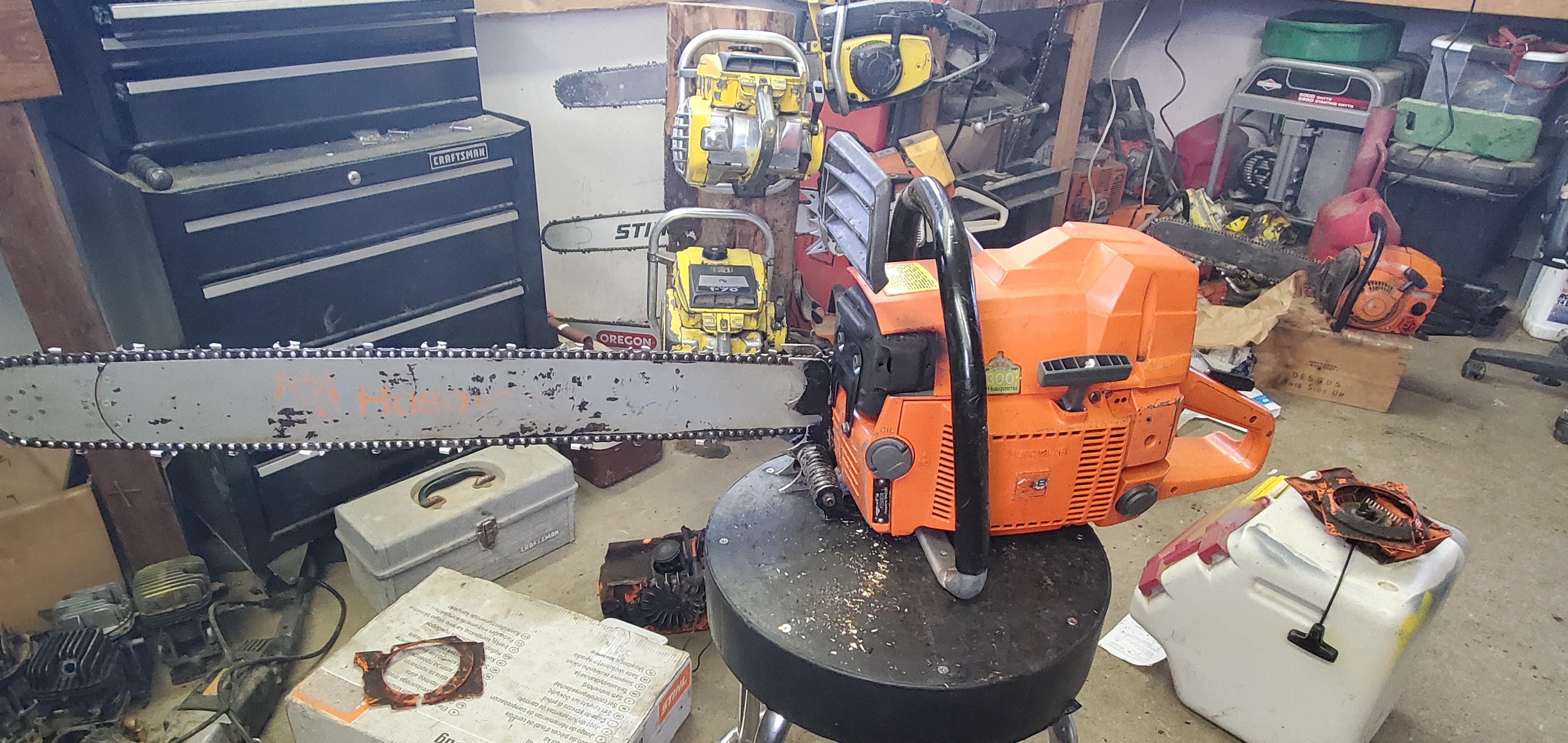

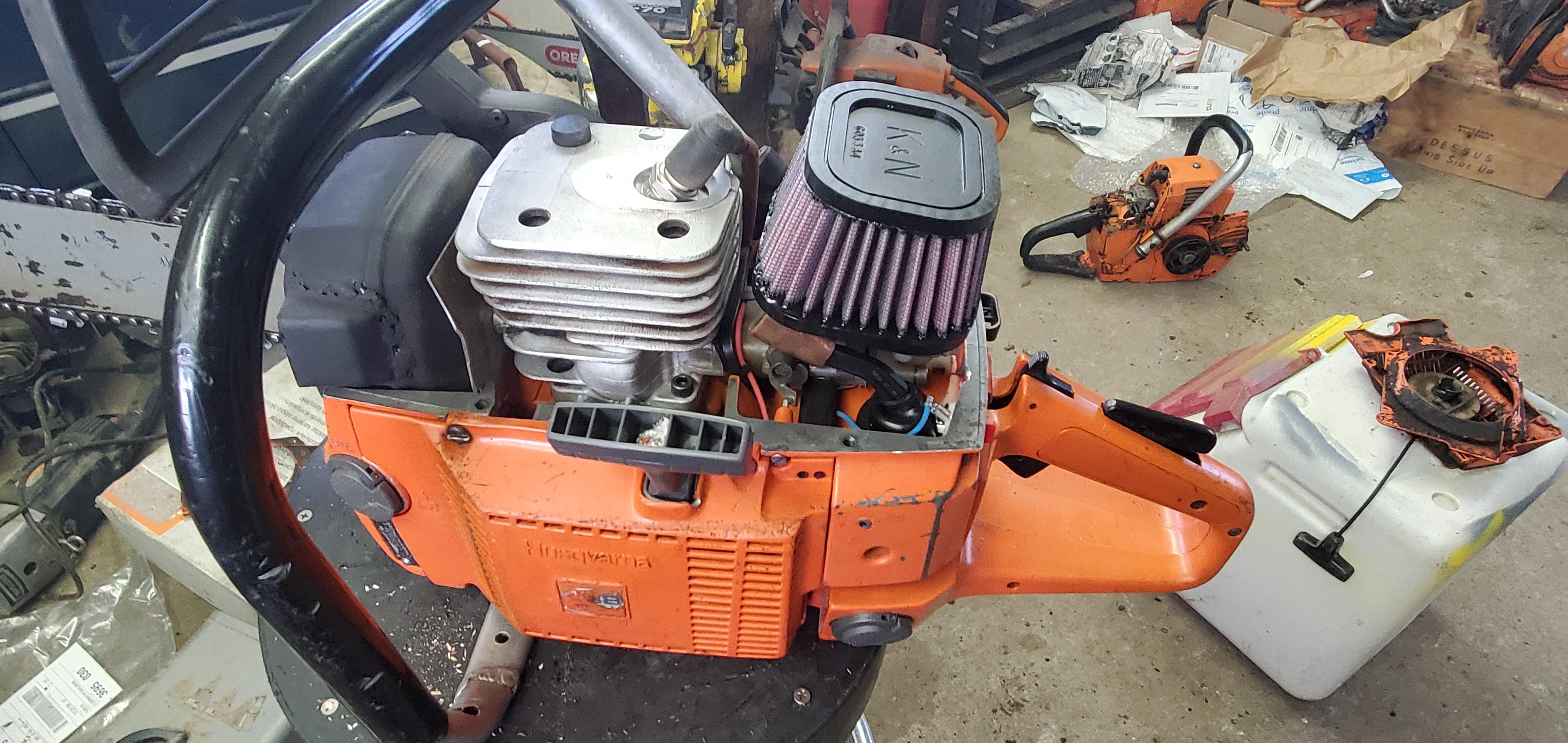

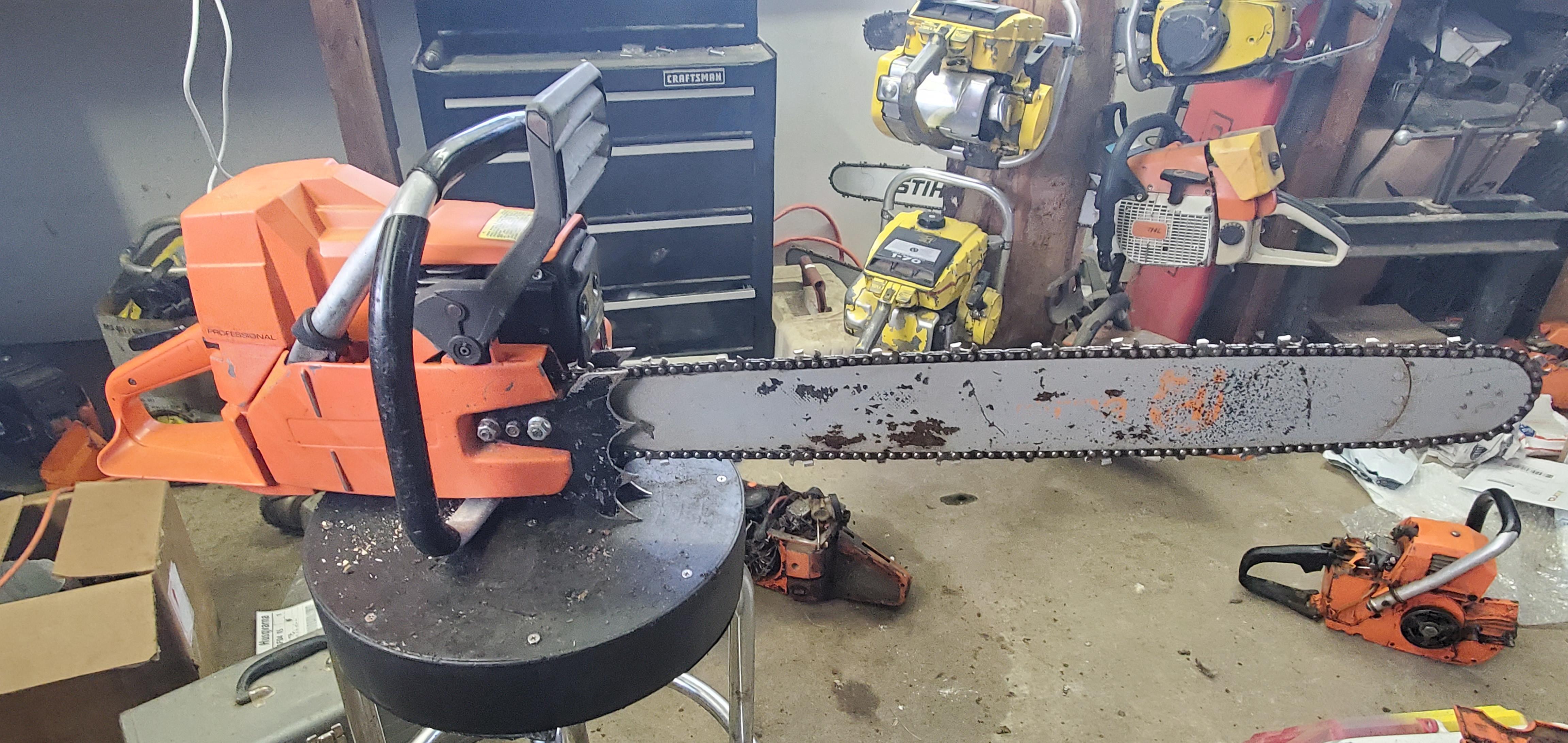

Just finished up an overhaul with a real classic. Thought you guys would appreciate it. 288 exx peee with the high top, original KS cylinder with nos piston and full wrap. Runs great, hell of a lot of power and compression. Very noisy too with the dual port muffler. When I brought it home it was rough but had a k&n with adapter. I decided to keep the adapter and got a new k&n filter for it. I have never run k&n filter on saws and have heard mixed opinions on them. The number one thing I've heard is that if you don't keep them oiled and cared for they can let fines in. That and working in dusty and really rough environments fines can get past them. Any thoughts or opinions on them?

Doesn't get much better than that. Im starting a 288 project right now. I have wanted one for some time. Now if I can just get my hands on a full wrap and high top cover i'll be set.
