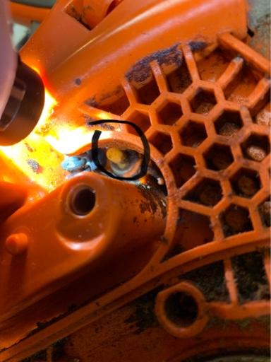

I had a 445 that was starving out for fuel. Tracked the problem down to the fuel tank vent being plugged.
No amount of carb cleaner under 10 psi from shop air would clear it. [emoji90]
There it is up by the fuel line ports.
A length of tygon with carb cleaner.
No joy so we re engineered it.
Drilled a hole for a duckbill at the handle mount.
A smear of 3M weatherstrip glue to seal and hold it in place. Stuffed cotton in the cavity behind side of the handle for a makeshift air filter.
We ran it steady cutting for 3/4 tank without it starving for fuel or leaking. [emoji108]
Fixed!!
